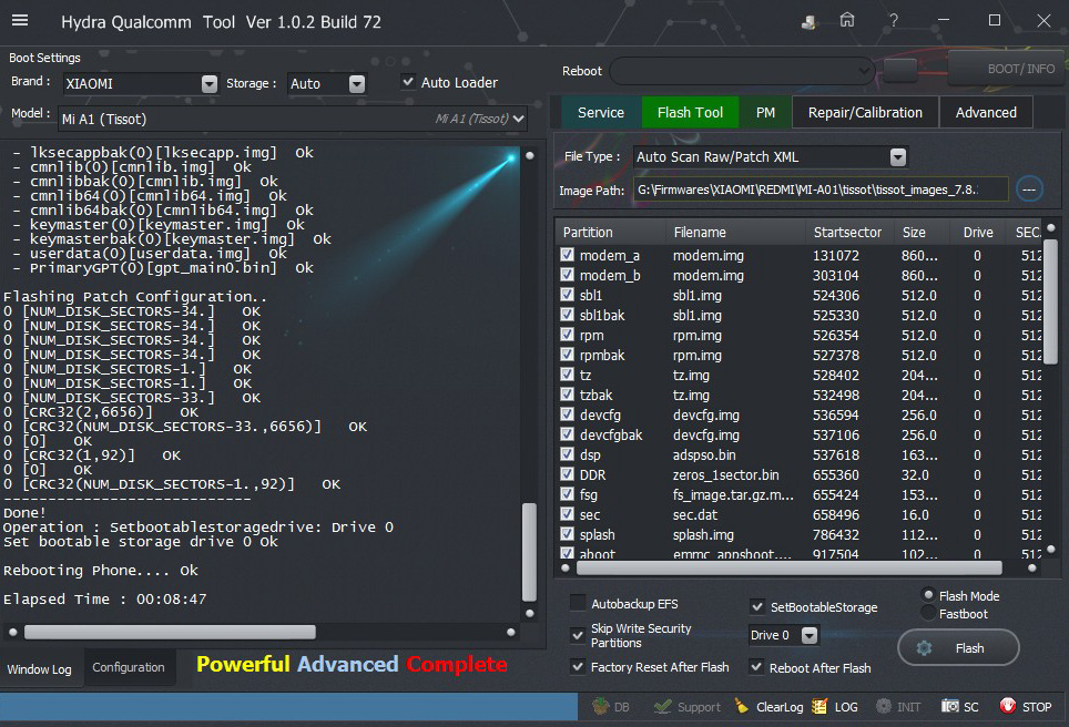

Hydra Xiaomi Mi A1 (Tissot) Successfully Flashed by Hydra Tool
546
FriendlyName :Qualcomm HS-USB QDLoader 9008 (COM293)
SymbolicName :\??\USB#VID_05C6&PID_9008#7&28b05c1c&0&3#{a5dcbf10-6530-11d2-901f-00c04fb951ed}
Getting device info......
Serial No.: 0xE8CACA41
MSM ID : 0x000460E1, MSM8953-Qualcomm Snapdragon 625
PBL Ver : 00000000
Firehose Loader[Mi_8953.mbn]
SaharaBoot... Ok
Sending ..................Ok
Connecting to Firehose...
Ping... Ok
Configuration......
Identifying Chip....
Ok
Chip Configuration :
MemoryName : eMMC
MaxXMLSizeInBytes : 4096
TargetName : 8953
Version : 1
*** STORAGE DEVICE INFO ***
Memory Type : eMMC
Block Size in Bytes : 512
Page Size : 512
Manufacturer ID : 144
Serial Number : 1004227769
Firmware Version : 162
Product Name : HCG8a4
Physical Partitions : 3
Total Logical Blocks:
Drive [0] 122142720[58,242 GB]
Drive [1] 8192[4 MB]
Drive [2] 8192[4 MB]
Protocol : Universal
Running : Ok
Phone Information.....
Brand : xiaomi
Vendor : Xiaomi
Model : MI 5X
SDK : 25
Release : 7.1.2
ABI : arm64-v8a
Locale : zh-CN
Description : tiffany-user 7.1.2 N2G47H 8.7.12 release-keys
Miui Ver : V10
Device : tiffany
Board : msm8953
Display ID : QL1515-tiffany-build-20180712004638
Security Patch : 2018-06-01
Emmc_size : 16GB
Platform : msm8953
Fingerprint : xiaomi/tiffany/tiffany:7.1.2/N2G47H/8.7.12:user/release-keys
- modem_a(0)[modem.img] Ok
- modem_b(0)[modem.img] Ok
- sbl1(0)[sbl1.img] Ok
- sbl1bak(0)[sbl1.img] Ok
- rpm(0)[rpm.img] Ok
- rpmbak(0)[rpm.img] Ok
- tz(0)[tz.img] Ok
- tzbak(0)[tz.img] Ok
- devcfg(0)[devcfg.img] Ok
- devcfgbak(0)[devcfg.img] Ok
- dsp(0)[adspso.bin] Ok
- DDR(0)[zeros_1sector.bin] Ok
- fsg(0)[fs_image.tar.gz.mbn.img] Skipped
- sec(0)[sec.dat] Skipped
- splash(0)[splash.img] Ok
- boot_a(0)[boot.img] Ok
- boot_b(0)[boot.img] Ok
- system_a(0)[system.img] Ok
- system_b(0)[system.img] Ok
- misc(0)[misc.img] Ok
- config(0)[zeros_1sector.bin] Skipped
- lksecapp(0)[lksecapp.img] Ok
- lksecappbak(0)[lksecapp.img] Ok
- cmnlib(0)[cmnlib.img] Ok
- cmnlibbak(0)[cmnlib.img] Ok
- cmnlib64(0)[cmnlib64.img] Ok
- cmnlib64bak(0)[cmnlib64.img] Ok
- keymaster(0)[keymaster.img] Ok
- keymasterbak(0)[keymaster.img] Ok
0 [NUM_DISK_SECTORS-34.] OK
0 [NUM_DISK_SECTORS-1.] OK
0 [NUM_DISK_SECTORS-33.] OK
0 [CRC32(2,6656)] OK
0 [CRC32(NUM_DISK_SECTORS-33.,6656)] OK
0 [0] OK
0 [CRC32(1,92)] OK
0 [0] OK
Done!
Rebooting Phone.... Ok
Elapsed Time : 00:08:47
