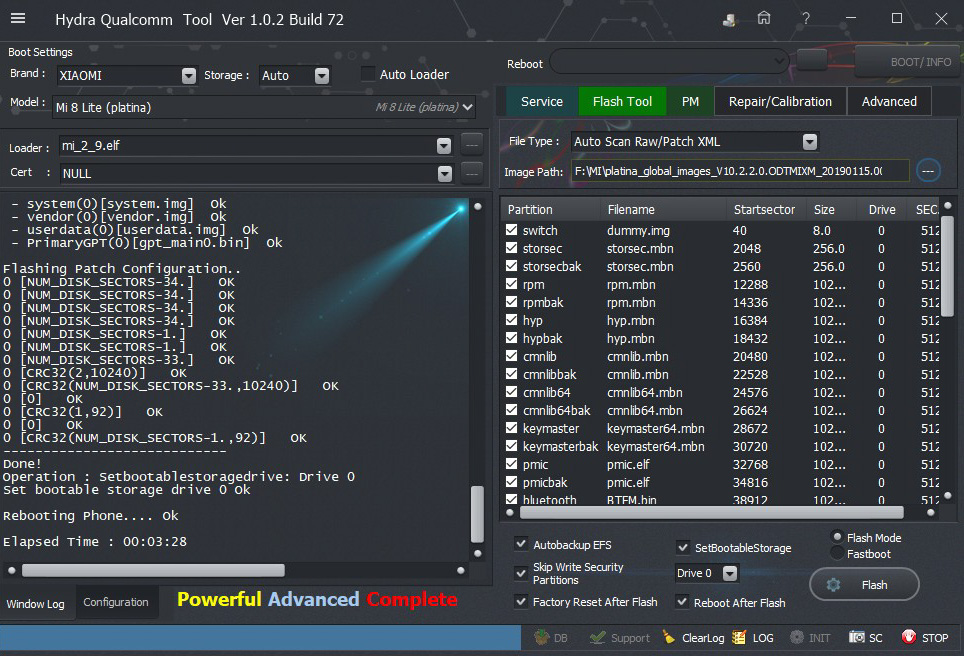

Xiaomi Mi 8 Lite (Platina) Flashing Successfully Done
FriendlyName :Qualcomm HS-USB QDLoader 9008 (COM45)
SymbolicName :\??\USB#VID_05C6&PID_9008#6&3ae11b61&0&1#{a5dcbf10-6530-11d2-901f-00c04fb951ed}
Driver Ver :10/21/2014,2.0.9.6
Getting device info......
Serial No.: 0x19AB6254
MSM ID : 0x0008C0E1, SDM660-Qualcomm Snapdragon 660
PBL Ver : 00000000
PK HASH : A7B8B82545A98ECA23D6E9105FB46456
8D1B5828264903441BDEF0CD57E3C370
Firehose Loader[mi_2_9.elf]
SaharaBoot... Ok
Sending ...............................Ok
Connecting to Firehose...
Ping......... Ok
Configuration......
Identifying Chip....
Ok
Chip Configuration :
MemoryName : eMMC
MaxXMLSizeInBytes : 4096
TargetName : MSM8996
Version : 1
DateTime : Aug 2 2018 - 22:27:53
*** STORAGE DEVICE INFO ***
Memory Type : eMMC
Block Size in Bytes : 512
Page Size : 512
Manufacturer ID : 144
Serial Number : 1669055522
Firmware Version : 875573296
Product Name : hC8aP>
Physical Partitions : 4
Total Logical Blocks:
Drive [0] 122142720[58,242 GB]
Drive [1] 8192[4 MB]
Drive [2] 8192[4 MB]
Drive [3] 32768[16 MB]
Protocol : Universal
Running : Ok
Phone Information......
Vendor : Xiaomi
SDK : 29
Release : 10
ABI : arm64-v8a
Locale : en-GB
Miui Ver : V12
Mod_device : platina_global
Security Patch : 2020-08-01
Reading GPT[4]
Drive [0] 80 Items
Drive [1] 0 Items
Drive [2] 0 Items
Drive [3]
Backup Security partitions...
Reading Security Items....
> modemst1
> modemst2
> fsg
C:\Hydra Tool\Backup\Security_Backup\__10_Security_022321191958.sec
Backup Security Success....
- switch(0)[dummy.img] Ok
- storsec(0)[storsec.mbn] Ok
- storsecbak(0)[storsec.mbn] Ok
- rpm(0)[rpm.mbn] Ok
- rpmbak(0)[rpm.mbn] Ok
- hyp(0)[hyp.mbn] Ok
- hypbak(0)[hyp.mbn] Ok
- cmnlib(0)[cmnlib.mbn] Ok
- cmnlibbak(0)[cmnlib.mbn] Ok
- cmnlib64(0)[cmnlib64.mbn] Ok
- cmnlib64bak(0)[cmnlib64.mbn] Ok
- keymaster(0)[keymaster64.mbn] Ok
- keymasterbak(0)[keymaster64.mbn] Ok
- pmic(0)[pmic.elf] Ok
- pmicbak(0)[pmic.elf] Ok
- bluetooth(0)[BTFM.bin] Ok
- devcfg(0)[devcfg.mbn] Ok
- devcfgbak(0)[devcfg.mbn] Ok
- abl(0)[abl.elf] Ok
- ablbak(0)[abl.elf] Ok
- misc(0)[dummy.img] Ok
- xbl(0)[xbl.elf] Ok
- xblbak(0)[xbl.elf] Ok
- tz(0)[tz.mbn] Ok
- tzbak(0)[tz.mbn] Ok
- logfs(0)[logfs_ufs_8mb.bin] Ok
- dsp(0)[dspso.bin] Ok
- logo(0)[logo.img] Ok
- boot(0)[boot.img] Ok
- modem(0)[NON-HLOS.bin] Ok
- cache(0)[cache.img] Ok
- cust(0)[cust.img] Ok
- system(0)[system.img] Ok
- vendor(0)[vendor.img] Ok
0 [NUM_DISK_SECTORS-34.] OK
0 [NUM_DISK_SECTORS-1.] OK
0 [NUM_DISK_SECTORS-33.] OK
0 [CRC32(2,10240)] OK
0 [CRC32(NUM_DISK_SECTORS-33.,10240)] OK
0 [0] OK
0 [CRC32(1,92)] OK
0 [0] OK
Done!
Rebooting Phone.... Ok
Elapsed Time : 00:03:28
