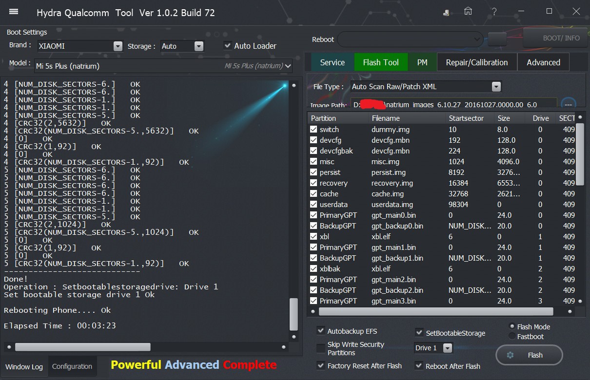

Hydra Xiaomi Mi 5S Plus (Natrium) successfully flashed by Hydra Tool
546
1. Run Hydra Qualcomm Tool
2. Choose "Brand" and "Module"
3. Go to "Flash Tool"
4. Click "Image Path" and choose correct Flash File
5. Click on "Flash" button.
6. Connect Device with Computer using USB Data Cable
7. Click on "Execute" button
8. Wait until the flashing process is completed.
9. Done
FriendlyName :Qualcomm HS-USB QDLoader 9008 (COM3)
SymbolicName :\??\USB#VID_05C6&PID_9008#5&b915705&0&2#{a5dcbf10-6530-11d2-901f-00c04fb951ed}
Driver Ver :08/31/2015,2.1.2.0
Getting device info......
Serial No.: 0x2B06EED4
MSM ID : 0x0005F0E1, MSM8996SG-Qualcomm Snapdragon 821
PBL Ver : 00000000
PK HASH : 355D47F912FEA0AF1F46C007C6DC22C4
3544FB9359E30AA7DB5F4734D18FBD74

Done!
Operation : Setbootablestoragedrive: Drive 1
Set bootable storage drive 1 Ok
Rebooting Phone.... Ok
Elapsed Time : 00:03:23​
