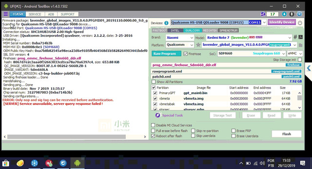

I have problem ... more than 5 days... i try to make some EDL Auth Xiaomi flash in many models (Mi9se / Mi9 / Redmi Note 7 / K20 / Mi9T) and UFI return same error when try to connect server to get authorization. I'm from Brazil, already try all the times and in the best time (9:30pm India Time) and never work... always return same error. Spend money in dongle and spend more money to buy credits to make this EDL Mi Auth Services here... Need Support and help to fix this. Please !!!!!
Always receive same error:
ERROR: Only nop and sig tag can be recevied before authentication.
[SERVER] Service unavailable, server query response failed !

I'm from Brazil... but try at all times ant server never respond... Already try in 9pm india time too... same error in screenshot

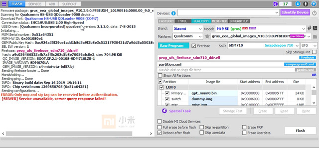

All phones is only bricked and not Find device On.... UFI Server Not Respond !!! See screenshots
The phone's dead, yes. But it is connected with Mi account, you need to log in to your account via PC and deactivate Find Devices. Then the flash can be performed. I had the same problem, I have solved.

This not is the real problem. The probem is UFI Auth Server

Actually, that is the problem. Other dongles too, show Server Offline if Find Device is ON.
Just get account and pass, go to i.mi.com, sign in and remove device from the list.
It is true, Xiaomi's new security doesn't allow to flash in edl if phone has Find Device ON before brick

Yes, i know... but the problem istill ocurr here all the times... in phones with find device off too... Whats the problem with UFI Server ?
