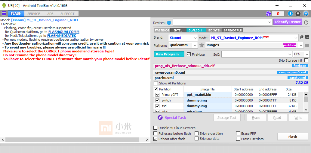

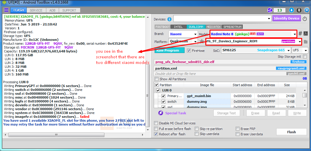

Good, look at the screenshot you have posted, xiaomi model with the variant of the xiaomi do not match, xiaomi note 8 ginko and you are going to flash with the eng firmware of the xiaomi mi 9T, normal error you.
Furthermore, Mr. Martview_Forum has already notified you of the error.

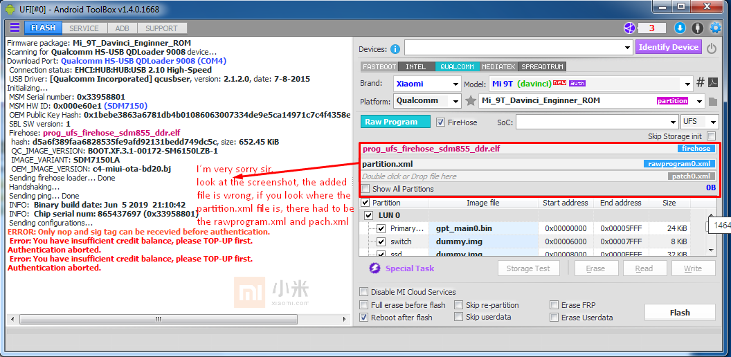

I'm very sorry sir, in case the text of the screenshot is not clear, the file you added is wrong, if you look at where the partition.xml file is, there had to be the rawprogram.xml and then the pacht.xml that is the correct thing, apart if it is fixed the same software puts it.
Good sir, please look at the screenshot, you have to put rawprogram.xml and patch0.xml not partition.xml file, look at screenshot please, thank you very much.
