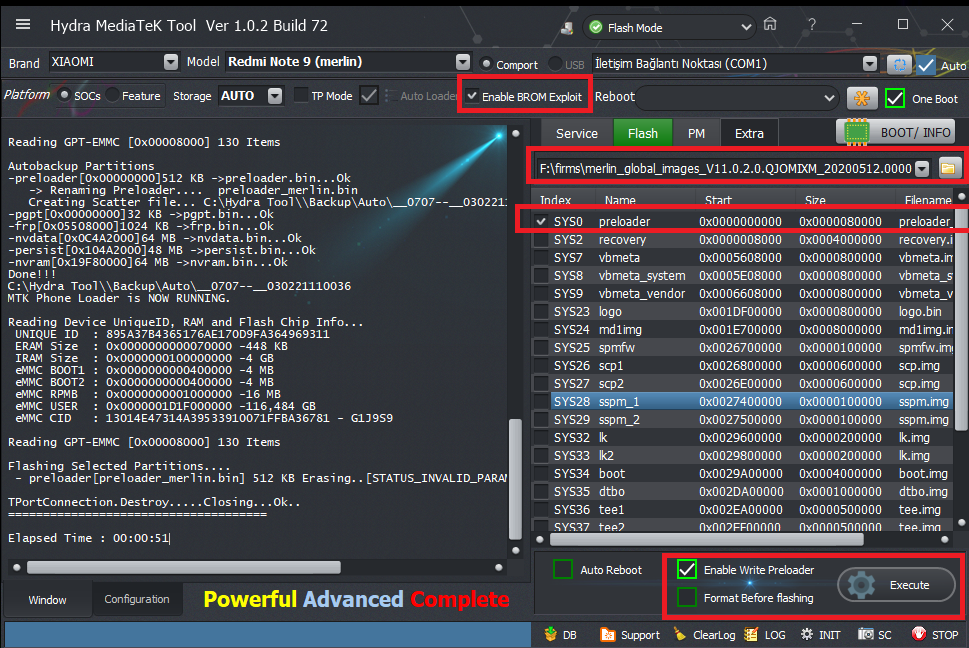

Step 1 - Writing SYS0 Preloader (Steps 1 to 10 )

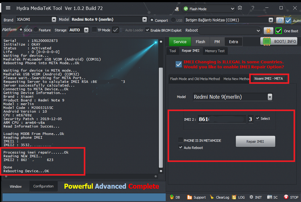

Step 2 - Repairing IMEI (Steps 11 to 23 )
1. Run Mediatek (MTK) Tool of Hydra Dongle.
2. Choose Platform as "SOCs"
3. Choose Brand as "Xiaomi" and Choose Model as "Redmi Note 9 (merlin)
(NOTE : This is example of repairing Xiomi Redmi Note 9 (merlin).
4. Tick "Enable BROM Exploit" (This is Important to tick)
5. Download firmware for Xiomi Redmi Note 9 (merlin)
6. Choose "Flash" tab.
7. Click on the flsh file icon just below "BOOT / INFO" menu to choose "flash file" and load it.
8. Just tick "SYS0" preloader (Untik all others except "SYS0" preloader).
9. Tick "Enable Write Preloader" just before "Execute" button.
10. Click "Execute" button.
11. Turn off device (cellphone / mobile) and insert USB cable to the device (Cellphone / Mobile).
12. Wait few seconds until the operation is completed.
13. Now, Click on "Service" Tab.
14. Click on "Repair IMEI" sub-tab just below "service" tab.
15. Tick "IMEI Changing is ILLEGAL is some countries, Would you like to enable IMEI repair Oprion ?"
16. Click on "Xiaomi IMEI - Meta"
17. Choose Model as "Redmi Note 9 (merlin)" drop down menu.
18. Tick "Select" to active IMEI BOX.
19. Type your desire IMEI
20. Click "Repair IMEI"
21. Wait until it is completed.
22. Turn off device (Cellphone / Mobile) and insert USB cable
23. Wait until operation is completed.
24. That's All. Good Luck!
