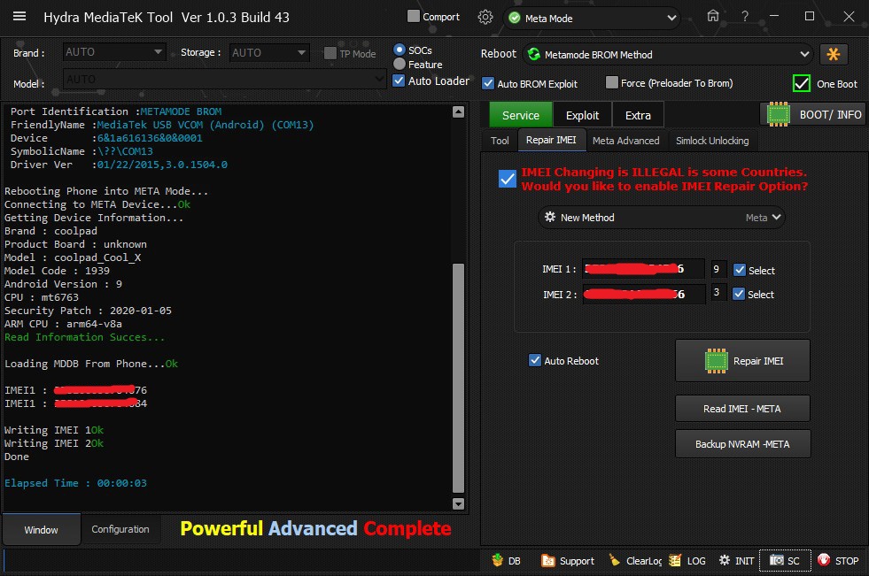

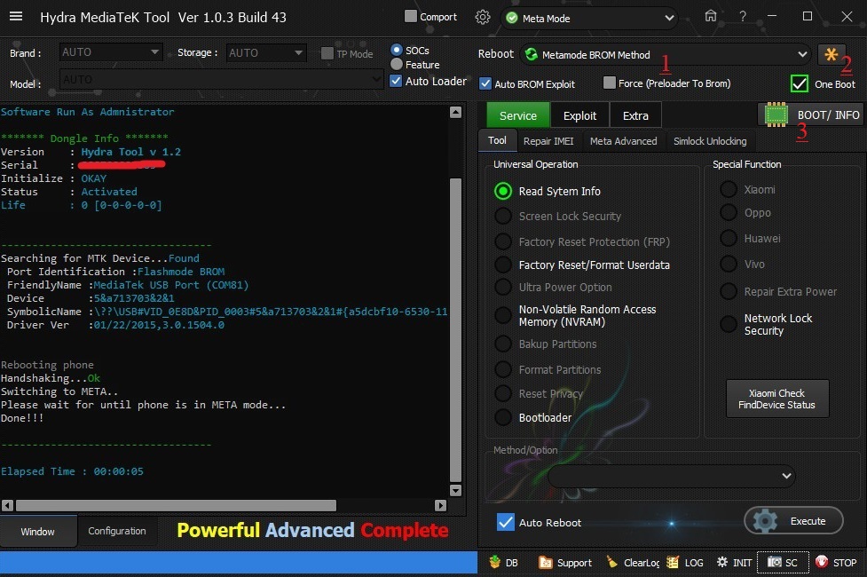

1. Run MTK Module of Hydra Tool
2. Choose Brand and Model as "Auto"
3. Choose "Metamood Broom" from Boot at the Top
4. Click on ( * ) Asterisk Mark on the Right Top Icon
5. Connect the device in Flash Mood using USB Data Cable
(Holding V+ and V- and insert USB Cable in it.)
6. Check the screen of the cellphone (Mobile) shows META MOOD or Not
7. Go to "Service " --> "Repair IMEI"
8. Tick "IMEI Changing is illigal........................................"
9. Choose "New Method " from META
10. Type the IMEI from the Battery Housing of the Cellphone or Mobile
(Original IMEI Written on the back Somewhere. Please check it.)
11. Click on "Write IMEI"
12. Wait until the operation is completed.
***IMEI REPAIR FUNCTION****
New Method
Port Identification :METAMODE BROM
FriendlyName :MediaTek USB VCOM (Android) (COM13)
Device :6&1a616136&0&0001
SymbolicName :\??\COM13
Rebooting Phone into META Mode...
Connecting to META Device...Ok
Getting Device Information...
Brand : coolpad
Product Board : unknown
Model : coolpad_Cool_X
Model Code : 1939
Android Version : 9
CPU : mt6763
Security Patch : 2020-01-05
ARM CPU : arm64-v8a
Read Information Succes...
Loading MDDB From Phone...Ok
IMEI1 : *************76
IMEI1 : *************84
Writing IMEI 1 Ok
Writing IMEI 2 Ok
Done
Elapsed Time : 00:00:03
