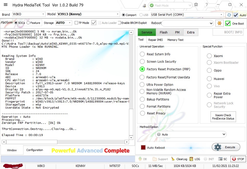

Brand : WIKO Model : V3913 (Kenny) Connection : Flash Mode
Connection
-Please wait...
-Connect Phone...
-Found...
-PreLoader...[COM42]
TPortConnection.Create...(COM42)..Opening...Ok
Handshaking...Ok
Identifying Hardware ID.....
BROM CPUID : 0335MT6737[6735]
BROM HW_SW_VER : 8A00 CB00 0000 0000
Handshaking...
FUSEID : 00000000
SECURE VERSION : 00
BL VERSION : 00
BR Secured : 00
NORMAL BOOT
Preparing Download Agent..
DA : 6735_SWSEC_Wiko.bin
Ver : MTK_AllInOne_DA_v3.3001.00.00
Init : Loader [1]
Sending : Accepted
Identifying Protocol...
Protocol : Old - eMMC
00000000000000000000
PRMMCCID : 460001154D32584E83D50642398A29DA
Init Configuration
Running DA 4.2 on BBID : 0x9B Ok
Initializing Loader [2]
Sending Loader [2] Accepted
Reading Flashchip data....
eMMC RPMB : 0x0000000000080000 -512 KB
eMMC USER : 0x00000001D2000000 -7,281 GB
ERAM Size : 0x0000000040000000 -1024 MB
IRAM Size : 0x0000000000020000 -128 KB
UNICAL RID : 75AB759B8A9C7FEB92E16E25D2996020
eMMC CID : 460001154D32584E83D50642395429DA
Change to HIGH SPEED...
5A
Connection
-Please wait...
-Found...[COM85]
Reading Partition Table
SIZE[0x00000898] 25 Items > Done
Reading System Info
Brand : WIKO
Vendor : WIKO
Model : KENNY
SDK : 24
Release : 7.0
ABI : armeabi-v7a
Description : full_v3913-user 7.0 NRD90M 1488199004 release-keys
Device : v3913
Display ID : alps-mp-n0.mp1-V1.0.2_tinno6737m.35.n_P182
Security Patch : 2017-07-05
Platform : mt6737m
FRPPST : /dev/block/platform/mtk-msdc.0/11230000.msdc0/by-name/frp
Fingerprint : WIKO/v3913/v3913:7.0/NRD90M/1488199004:user/release-keys
StorageType : mtp
Autobackup Partitions
-preloader[0x00000000] 512 KB -> preloader.bin...Ok
-> Renaming Preloader.... preloader_v3913.bin
Creating Scatter file... C:\Hydra Tool\\Backup\Auto\WIKO_KENNY_0335-mt6737m-7.0_alps-mp-n0.mp1-V1.0.2_tinno6737m.35.n_P182_110221112317\MT6737_Android_scatter.txt
-nvram[0x00380000] 5 MB -> nvram.bin...Ok
-frp[0x07E00000] 1024 KB -> frp.bin...Ok
-nvdata[0x07F00000] 32 MB -> nvdata.bin...Ok
Done!!!
Reading System Info
Brand : WIKO
Vendor : WIKO
Model : KENNY
SDK : 24
Release : 7.0
ABI : armeabi-v7a
Device : v3913
Platform : mt6737m
StorageType : mtp
Operation : Auto
Processing...
ZeroWipe FRP Partition... [Ok] Ok
Elapsed Time : 00:00:19
