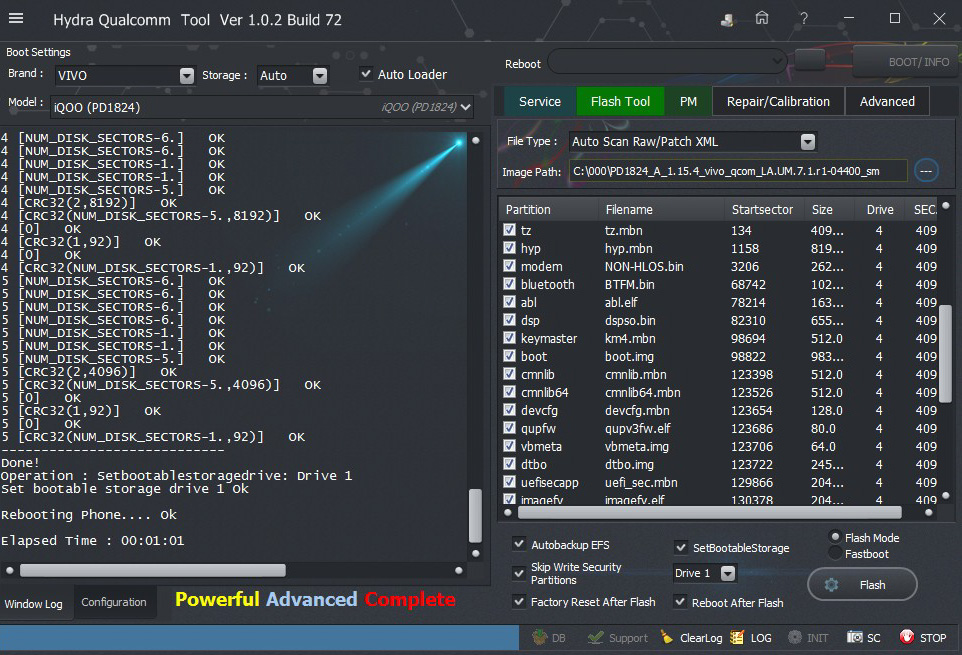

Hydra Vovo IQOO (PD1824) Successfully flashed by Hydra Tool
546
FriendlyName :Qualcomm HS-USB QDLoader 9008 (COM26)
SymbolicName :\??\USB#VID_05C6&PID_9008#5&4ec4a96&0&2#{a5dcbf10-6530-11d2-901f-00c04fb951ed}
Driver Ver :12/06/2012,2.1.0.5
Getting device info......
Serial No.: 0x87D881BB
MSM ID : 0x000A50E1, SDM855-Qualcomm Snapdragon 855
PBL Ver : 00000000
PK HASH : A7DF36FFD7AB557C67A6C26675E2795C
922CF671308CFD7169BEDB84424C862B
Firehose Loader[Vivo_iQOONeo855.elf]
SaharaBoot... Ok
Sending .....................................Ok
Connecting to Firehose...
Ping...................... Ok
Configuration........
Identifying Chip........UFS
Ok
Chip Configuration :
MemoryName : UFS
MaxXMLSizeInBytes : 4096
TargetName :
Version : 1
DateTime : Oct 30 2020 - 10:53:30
*** STORAGE DEVICE INFO ***
Memory Type : UFS
Block Size in Bytes : 4096
Page Size : 4096
Manufacturer ID : 462
Serial Number : 1297306958
Firmware Version : 900
Product Name : KLUDG4U1EA-B0C1
Physical Partitions : 6
Total Logical Blocks:
Drive [0] 30947328[118.055 GB]
Drive [1] 2048[8 MB]
Drive [2] 2048[8 MB]
Drive [3] 8192[32 MB]
Drive [4] 262144[1024 MB]
Drive [5] 16384[64 MB]
Protocol : Universal
Running : Ok
Phone Information......
Brand : vivo
Vendor : vivo
Model : vivo
SDK : 28
Release : 9
ABI : arm64-v8a
Locale : zh-CN
Description : msmnile-user 9 PKQ1.181216.001 compiler01102012 release-keys
Device : PD1824
Display ID : PKQ1.181216.001 release-keys
Security Patch : 2020-01-01
Platform : =SM8150
Fingerprint : vivo/PD1824/PD1824:9/PKQ1.181216.001/compiler01102012:user/release-keys
Reading GPT[6]
Drive [0] 32 Items
Drive [1] 32 Items
Drive [2] 32 Items
Drive [3] 32 Items
Drive [4] 64 Items
Drive [5] 32 Items
Backup Security partitions...
Reading Security Items....
> modemst1
> modemst2
No response from phone...
> fsg
C:\Hydra Tool\Backup\Security_Backup\vivo__9_Security_020421214213.sec
Backup Security Success....
- survival(0)[survival.img] Ok
- xbl(1)[xbl.elf] Ok
- xbl_config(1)[xbl_config.elf] Ok
- PrimaryGPT(1)[gpt_main1.bin] Ok
- PrimaryGPT(2)[gpt_main2.bin] Ok
- PrimaryGPT(3)[gpt_main3.bin] Ok
- aop(4)[aop.mbn] Ok
- tz(4)[tz.mbn] Ok
- hyp(4)[hyp.mbn] Ok
- modem(4)[NON-HLOS.bin] Ok
- bluetooth(4)[BTFM.bin] Ok
- abl(4)[abl.elf] Ok
- dsp(4)[dspso.bin] Ok
- keymaster(4)[km4.mbn] Ok
- boot(4)[boot.img] Ok
- cmnlib(4)[cmnlib.mbn] Ok
- cmnlib64(4)[cmnlib64.mbn] Ok
- devcfg(4)[devcfg.mbn] Ok
- qupfw(4)[qupv3fw.elf] Ok
- vbmeta(4)[vbmeta.img] Ok
- dtbo(4)[dtbo.img] Ok
- uefisecapp(4)[uefi_sec.mbn] Ok
- imagefv(4)[imagefv.elf] Ok
- logfs(4)[logfs_ufs_8mb.bin] Ok
- storsec(4)[storsec.mbn] Ok
- multiimgoem(4)[multi_image.mbn] Ok
- secdata(4)[sec.elf] Ok
- PrimaryGPT(4)[gpt_main4.bin] Ok
- modemst1(5)[modemst.mbn] Skipped
- modemst2(5)[modemst.mbn] Skipped
- fsg(5)[PD1824_fs_image.tar.gz.mbn.img] Skipped
- PrimaryGPT(5)[gpt_main5.bin] Ok
0 [NUM_DISK_SECTORS-6.] OK
0 [NUM_DISK_SECTORS-1.] OK
0 [NUM_DISK_SECTORS-5.] OK
0 [CRC32(2,4096)] OK
0 [CRC32(NUM_DISK_SECTORS-5.,4096)] OK
0 [0] OK
0 [CRC32(1,92)] OK
0 [0] OK
1 [NUM_DISK_SECTORS-6.] OK
1 [NUM_DISK_SECTORS-1.] OK
1 [NUM_DISK_SECTORS-5.] OK
1 [CRC32(2,4096)] OK
1 [CRC32(NUM_DISK_SECTORS-5.,4096)] OK
1 [0] OK
1 [CRC32(1,92)] OK
1 [0] OK
1 [CRC32(NUM_DISK_SECTORS-1.,92)] OK
2 [NUM_DISK_SECTORS-6.] OK
2 [NUM_DISK_SECTORS-1.] OK
2 [NUM_DISK_SECTORS-5.] OK
2 [CRC32(2,4096)] OK
2 [CRC32(NUM_DISK_SECTORS-5.,4096)] OK
2 [0] OK
2 [CRC32(1,92)] OK
2 [0] OK
2 [CRC32(NUM_DISK_SECTORS-1.,92)] OK
3 [NUM_DISK_SECTORS-6.] OK
3 [NUM_DISK_SECTORS-1.] OK
3 [NUM_DISK_SECTORS-5.] OK
3 [CRC32(2,4096)] OK
3 [CRC32(NUM_DISK_SECTORS-5.,4096)] OK
3 [0] OK
3 [CRC32(1,92)] OK
3 [0] OK
3 [CRC32(NUM_DISK_SECTORS-1.,92)] OK
4 [NUM_DISK_SECTORS-6.] OK
4 [NUM_DISK_SECTORS-1.] OK
4 [NUM_DISK_SECTORS-5.] OK
4 [CRC32(2,8192)] OK
4 [CRC32(NUM_DISK_SECTORS-5.,8192)] OK
4 [0] OK
4 [CRC32(1,92)] OK
4 [0] OK
4 [CRC32(NUM_DISK_SECTORS-1.,92)] OK
5 [NUM_DISK_SECTORS-6.] OK
5 [NUM_DISK_SECTORS-1.] OK
5 [NUM_DISK_SECTORS-5.] OK
5 [CRC32(2,4096)] OK
5 [CRC32(NUM_DISK_SECTORS-5.,4096)] OK
5 [0] OK
5 [CRC32(1,92)] OK
5 [0] OK
5 [CRC32(NUM_DISK_SECTORS-1.,92)] OK
Done!
Operation : Setbootablestoragedrive: Drive 1
Set bootable storage drive 1 Ok
Rebooting Phone.... Ok
Elapsed Time : 00:01:01
