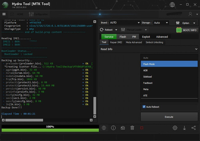

vivo Y83 Pro Pattern and FRP lock Remove with Hydra Tool
- Keep press boot info
To Enable BROM  Mode :
     Method 1    - Bootkey (Vol + - Power) or any combination
     Method 2    - Enable Preloader to brom(crashing Method)
     Method 3    - Test Point Data0 + ground
To Enable Preloader  Mode :
     Method 1    - Just Insert cable
  MTK Port Type   : Flashmode BROM
  FriendlyName    : MediaTek USB Port_V1632 (COM40)
  Device          : /6&2bbff36a&0&3
  SymbolicName    : \\?\usb#vid_0e8d&pid_0003#6&2bbff36a&0&3#{a5dcbf10-6530-11d2-901f-00c04fb951ed}
  Driver Ver      : 01/22/2015,3.0.1504.0
  Service         : wdm_usb
Openning Port [COM40] Ok
Handshaking...Ok
  HwCode          : 0766 {MT6765/MT8768t}
  Hwver           : 0000
  Target config   : E5
  SBC             : 01 (True)
  SLA             : 00 (False)
  DAA             : 04 (True)
  SWJTAG          : 04 (True)
  EPP             : 00 (False)
  CERT            : 00 (False)
  MEMREAD         : 20 (True)
  MEMWRITE        : 40 (True)
  CMD_C8          : 80 (True)
  Connection      : BROM
  HW Subcode      : 8A00
  HW Subcode      : CA00
  SW Ver          : 0000
  ME_ID           : 0D397390757A15D9DA5B64964B4E57D5
  SOC_ID          : 2C30B820CC9EA73B49DE936F8ACC58EB8D0D8CC8CEB4C45FFC8EFA20D25558D0
Exploiting Device...
Successfully Exploited..
Handshaking...Ok
Seeking preloader address..
Not Found
  Target config   : 00
  SBC             : 00 (False)
  SLA             : 00 (False)
  DAA             : 00 (False)
  SWJTAG          : 00 (False)
  EPP             : 00 (False)
  CERT            : 00 (False)
  MEMREAD         : 00 (False)
  MEMWRITE        : 00 (False)
  CMD_C8          : 00 (False)
  Connection      : BROM
Patching da2 ... Ok
Uploading Stage 1....
Jumping to 0x00200000 Ok 0xC0
Successfully received DA sync
  ONNECTION_AGENT : brom
  DRAM config needed for : 150100524436344D
Sending auto preloader from dump...
Hydra Auto Preloader Search Enabled..
Hydra will find compatible preloader files...
Found 10 Compatible Preloaders..
1-preloader_blackjack_64.bin...Sending... [DRAM setup passed.] [Ok]
Sending emi data succeeded.
Uploading stage 2...
Successfully uploaded stage 2
  ERAM Size       : 0x000000000003A000-232 KB
  IRAM Size       : 0x0000000100000000-4 GB
  EMMC RPMB Size  : 0x0000000000400000-4 MB
  EMMC USER Size  : 0x0000000747C00000-29.121 GB
  EMMC CID        : 150100524436344D42017128CEE61511 - RD64MB
  HW-CODE         : 0x766
  HWSUB-CODE      : 0x8A00
  HW-VERSION      : 0xCA00
  SW-VERSION      : 0x0
  CHIP-EVOLUTION  : 0x0
  DA-VERSION      : 1.0
  Speed           : high-speed
Reading Partition Table ..
Partition Count : 45
  Brand          : vivo
  Vendor         : vivo
  Model          : vivo 1726
  Product        : k62v1_64_bsp
  Manufacturer   : vivo
  SDK            : 27
  Release        : 8.1.0
  ABI            : arm64-v8a
  CPU abilist    : arm64-v8a,armeabi-v7a,armeabi
  Locale         : en-US
  Description    : full_k62v1_64_bsp-user 8.1.0 O11019 1661156809 release-keys
  Device         : PD1803F_EX
  Display ID     : O11019 release-keys
  Security Patch : 2021-03-01
  Platform       : =MTK6765
  Fingerprint    : vivo/1726/1726:8.1.0/O11019/1661156809:user/release-keys
  StorageType    : mtp
Reading IMEI........
IMEI1 : 8699380*********
IMEI2 : 8699380*********
Bootloader Status...
  Bootloader : Locked
Backing up Security..
- preloader(preloader.bin), 512 KB                    = Ok  [preloader_k62v1_64_bsp.bin]
  *Creating Scatter file... C:\Hydra Tool\Backup\MTKBKUP\0766_0D397390757A15D9DVVDDD64964B4E57D5\Auto\072423173411\6765_Android_scatter.txt
- pgpt(pgpt.bin), 32 KB                               = Ok
- nvram(nvram.bin), 64 MB                             = Ok
- nvdata(nvdata.bin), 64 MB                           = Ok
- frp(frp.bin), 1024 KB                               = Ok
- protect1(protect1.bin), 8 MB                        = Ok
- protect2(protect2.bin), 15.469 MB                   = Ok
- persist(persist.bin), 48 MB                         = Ok
- proinfo(proinfo.bin), 3 MB                          = Ok
- nvcfg(nvcfg.bin), 32 MB                             = Ok
- sec1(sec1.bin), 2 MB                                = Ok
- seccfg(seccfg.bin), 8 MB                            = Ok
- lk(lk.bin), 5 MB                                    = Ok
Backup Done!!!
Elapsed Time : 00:01:21

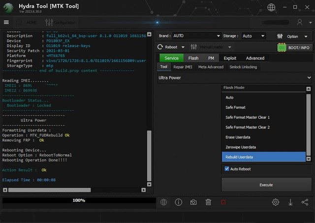

- Service Function
- Ultra Power
- Rebuild Userdata
                      Service Function
                        Ultra Power
                      Rebuild Userdata
  Service         : wdm_usb
  HW-CODE         : 0x766
  HWSUB-CODE      : 0x8A00
  HW-VERSION      : 0xCA00
  SW-VERSION      : 0x0
  DA-VERSION      : 1.0
  Speed           : high-speed
  Brand          : vivo
  Vendor         : vivo
  Model          : vivo 1726
  Manufacturer   : vivo
  SDK            : 27
  Release        : 8.1.0
  ABI            : arm64-v8a
  Locale         : en-US
  Device         : PD1803F_EX
  Platform       : =MTK6765
  StorageType    : mtp
IMEI1 : 86993**********
IMEI2 : 86993**********
  Bootloader : Locked
        Ultra Power
Formatting Userdata :
Operation : MTK_FUDRebuild Ok
Removing FRP :  Ok
Rebooting Device...
Rebooting Operation Done!!!!
Action Result :  Ok
Elapsed Time : 00:00:08
