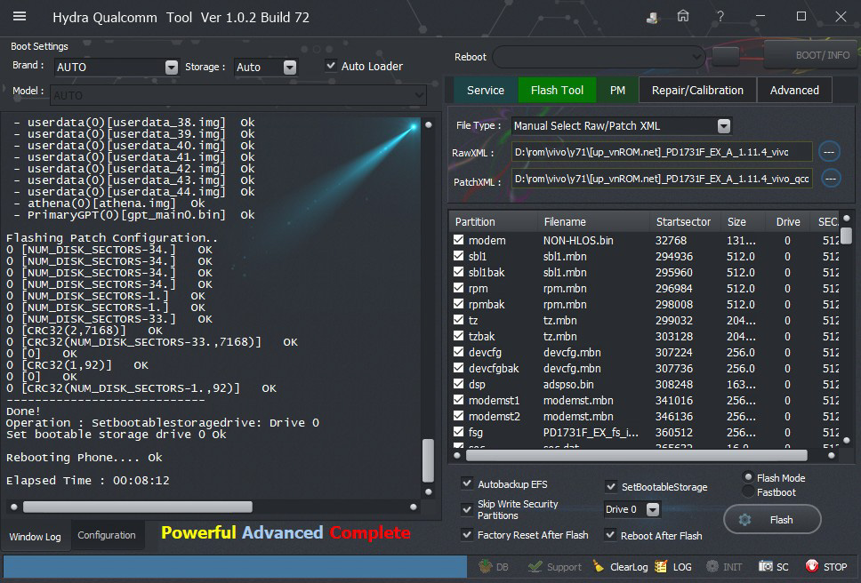

Vivo Y71 Successfully Flashed by Hydra Tool
FriendlyName :Qualcomm HS-USB QDLoader 9008 (COM17)
SymbolicName :\??\USB#VID_05C6&PID_9008#5&1f66f1ac&0&1#{a5dcbf10-6530-11d2-901f-00c04fb951ed}
Driver Ver :03/27/2013,1.0.8.2
Getting device info......
Serial No.: 0x080FC142
MSM ID : 0x000560E1, MSM8917-Qualcomm Snapdragon 425
PBL Ver : 00000000
PK HASH : 60BA997FEF6DA9F05885FA11F1DD6D2A
90D052A257A09C2075D7246CC73C0D43
Firehose Loader[8917.mbn]
SaharaBoot... Ok
Sending .................Ok
Connecting to Firehose...
Ping... Ok
Configuration......
Identifying Chip....
Ok
Chip Configuration :
MemoryName : eMMC
MaxXMLSizeInBytes : 4096
TargetName : 8917
Version : 1
*** STORAGE DEVICE INFO ***
Memory Type : eMMC
Block Size in Bytes : 512
Page Size : 512
Manufacturer ID : 144
Serial Number : 3326636100
Firmware Version : 165
Product Name : HBG4a2
Physical Partitions : 3
Total Logical Blocks:
Drive [0] 61071360[29.121 GB]
Drive [1] 8192[4 MB]
Drive [2] 8192[4 MB]
Protocol : Universal
Running : Ok
Phone Information.....
Brand : vivo
Vendor : vivo
Model : vivo 1724
SDK : 27
Release : 8.1.0
ABI : arm64-v8a
Locale : en-US
Description : msm8937_64-user 8.1.0 OPM1.171019.011 eng.compil.20201019.202120 release-keys
Device : msm8937_64
Display ID : OPM1.171019.011 release-keys
Security Patch : 2020-10-01
Emmc_size : 16GB
Platform : =QCOM8917
Fingerprint : vivo/1724/1724:8.1.0/OPM1.171019.011/compil10192021:user/release-keys
Reading GPT[3]
Drive [0] 56 Items
Drive [1] 0 Items
Drive [2] 0 Items
Backup Security partitions...
Reading Security Items....
> modemst1
> modemst2
> fsg
C:\Hydra Tool\Backup\Security_Backup\vivo 1724__8.1.0_Security_012221124923.sec
Backup Security Success....
- modem(0)[NON-HLOS.bin] Ok
- sbl1(0)[sbl1.mbn] Ok
- sbl1bak(0)[sbl1.mbn] Ok
- rpm(0)[rpm.mbn] Ok
- rpmbak(0)[rpm.mbn] Ok
- tz(0)[tz.mbn] Ok
- tzbak(0)[tz.mbn] Ok
- devcfg(0)[devcfg.mbn] Ok
- devcfgbak(0)[devcfg.mbn] Ok
- dsp(0)[adspso.bin] Ok
- modemst1(0)[modemst.mbn] Skipped
- modemst2(0)[modemst.mbn] Skipped
- fsg(0)[PD1731F_EX_fs_image.tar.gz.mbn.img] Skipped
- sec(0)[sec.dat] Skipped
- boot(0)[boot.img] Ok
- system(0)[system_1.img] Ok
- system(0)[system_2.img] Ok
- system(0)[system_3.img] Ok
- system(0)[system_4.img] Ok
- system(0)[system_5.img] Ok
- system(0)[system_6.img] Ok
- system(0)[system_7.img] Ok
- system(0)[system_8.img] Ok
- system(0)[system_9.img] Ok
- system(0)[system_10.img] Ok
- system(0)[system_11.img] Ok
- system(0)[system_12.img] Ok
- system(0)[system_13.img] Ok
- system(0)[system_14.img] Ok
- system(0)[system_15.img] Ok
- system(0)[system_16.img] Ok
- system(0)[system_17.img] Ok
- system(0)[system_18.img] Ok
- system(0)[system_19.img] Ok
- system(0)[system_20.img] Ok
- system(0)[system_21.img] Ok
- system(0)[system_22.img] Ok
- system(0)[system_23.img] Ok
- system(0)[system_24.img] Ok
- system(0)[system_25.img] Ok
- system(0)[system_26.img] Ok
- system(0)[system_27.img] Ok
- system(0)[system_28.img] Ok
- system(0)[system_29.img] Ok
- system(0)[system_30.img] Ok
- system(0)[system_31.img] Ok
- system(0)[system_32.img] Ok
- system(0)[system_33.img] Ok
- system(0)[system_34.img] Ok
- system(0)[system_35.img] Ok
- system(0)[system_36.img] Ok
- system(0)[system_37.img] Ok
- system(0)[system_38.img] Ok
- vendor(0)[vendor_1.img] Ok
- vendor(0)[vendor_2.img] Ok
- vendor(0)[vendor_3.img] Ok
- vendor(0)[vendor_4.img] Ok
- vendor(0)[vendor_5.img] Ok
- vendor(0)[vendor_6.img] Ok
- vendor(0)[vendor_7.img] Ok
- vendor(0)[vendor_8.img] Ok
- vendor(0)[vendor_9.img] Ok
- vendor(0)[vendor_10.img] Ok
- vendor(0)[vendor_11.img] Ok
- vendor(0)[vendor_12.img] Ok
- vendor(0)[vendor_13.img] Ok
- vendor(0)[vendor_14.img] Ok
- cache(0)[cache_1.img] Ok
- cache(0)[cache_2.img] Ok
- cache(0)[cache_3.img] Ok
- persist(0)[persist_1.img] Skipped
- oem(0)[oem_PD1731BF_EX_TH_NULL_DTAC_1.img] Ok
- oem(0)[oem_PD1731BF_EX_TH_NULL_DTAC_2.img] Ok
- mdtp(0)[mdtp.img] Ok
- cmnlib(0)[cmnlib_30.mbn] Ok
- cmnlibbak(0)[cmnlib_30.mbn] Ok
- cmnlib64(0)[cmnlib64_30.mbn] Ok
- cmnlib64bak(0)[cmnlib64_30.mbn] Ok
- keymaster(0)[keymaster64.mbn] Ok
- keymasterbak(0)[keymaster64.mbn] Ok
- survival(0)[survival.img] Ok
- userdata(0)[userdata_1.img] Ok
- userdata(0)[userdata_2.img] Ok
- userdata(0)[userdata_3.img] Ok
- userdata(0)[userdata_4.img] Ok
- userdata(0)[userdata_5.img] Ok
- userdata(0)[userdata_6.img] Ok
- userdata(0)[userdata_7.img] Ok
- userdata(0)[userdata_8.img] Ok
- userdata(0)[userdata_9.img] Ok
- userdata(0)[userdata_10.img] Ok
- userdata(0)[userdata_11.img] Ok
- userdata(0)[userdata_12.img] Ok
- userdata(0)[userdata_13.img] Ok
- userdata(0)[userdata_14.img] Ok
- userdata(0)[userdata_15.img] Ok
- userdata(0)[userdata_16.img] Ok
- userdata(0)[userdata_17.img] Ok
- userdata(0)[userdata_18.img] Ok
- userdata(0)[userdata_19.img] Ok
- userdata(0)[userdata_20.img] Ok
- userdata(0)[userdata_21.img] Ok
- userdata(0)[userdata_22.img] Ok
- userdata(0)[userdata_23.img] Ok
- userdata(0)[userdata_24.img] Ok
- userdata(0)[userdata_25.img] Ok
- userdata(0)[userdata_26.img] Ok
- userdata(0)[userdata_27.img] Ok
- userdata(0)[userdata_28.img] Ok
- userdata(0)[userdata_29.img] Ok
- userdata(0)[userdata_30.img] Ok
- userdata(0)[userdata_31.img] Ok
- userdata(0)[userdata_32.img] Ok
- userdata(0)[userdata_33.img] Ok
- userdata(0)[userdata_34.img] Ok
- userdata(0)[userdata_35.img] Ok
- userdata(0)[userdata_36.img] Ok
- userdata(0)[userdata_37.img] Ok
- userdata(0)[userdata_38.img] Ok
- userdata(0)[userdata_39.img] Ok
- userdata(0)[userdata_40.img] Ok
- userdata(0)[userdata_41.img] Ok
- userdata(0)[userdata_42.img] Ok
- userdata(0)[userdata_43.img] Ok
- userdata(0)[userdata_44.img] Ok
- athena(0)[athena.img] Ok
0 [NUM_DISK_SECTORS-34.] OK
0 [NUM_DISK_SECTORS-1.] OK
0 [NUM_DISK_SECTORS-33.] OK
0 [CRC32(2,7168)] OK
0 [CRC32(NUM_DISK_SECTORS-33.,7168)] OK
0 [0] OK
0 [CRC32(1,92)] OK
0 [0] OK
Done!
Rebooting Phone.... Ok
Elapsed Time : 00:08:12
