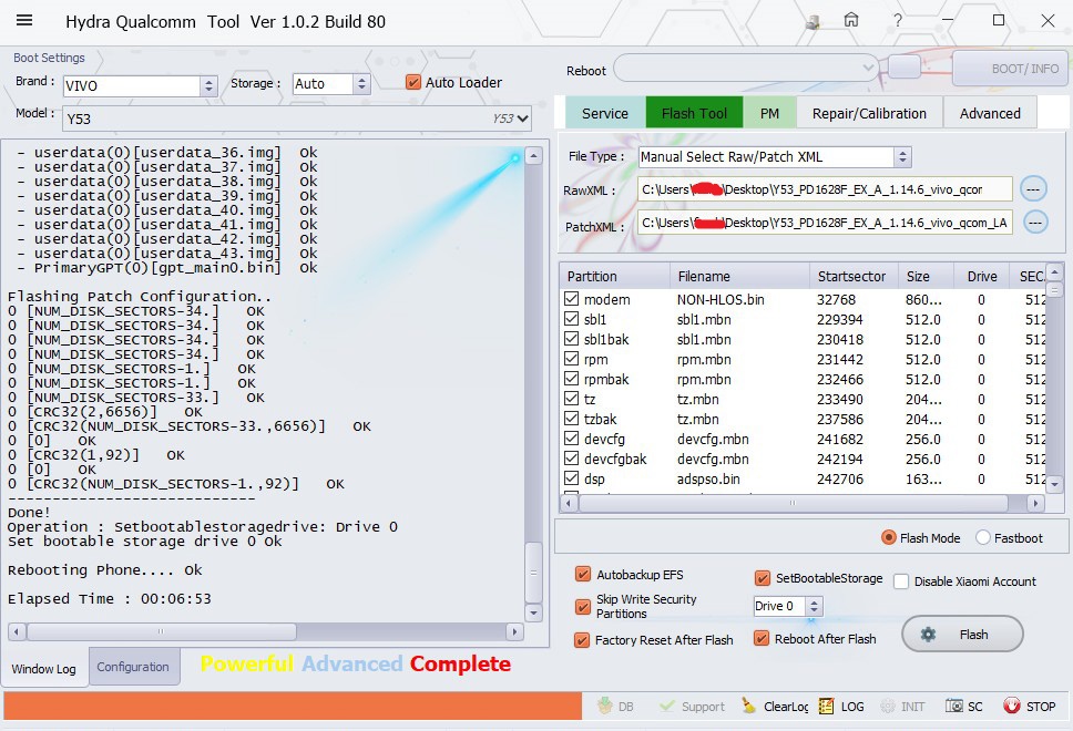

Vivo Y53 successfully flashed by Hydra Tool
1. Run Vivo Quacomm Tool
2. Go to "Flash Tool" Tab
3. Choose File Types "RawXML" and "PatchXML"
4. Choose "Flash Mode" or "FastBoot" mode (Either One)
4. Click on "EXECUTE"
5. Insert Device with computer using USB Data Cable
6. Wait until the operation is completed.
7.Done.
7.Done.
BRSearching for Qualcomm 9008 Device...Found
FriendlyName :Qualcomm HS-USB QDLoader 9008 (COM33)
SymbolicName :\??\USB#VID_05C6&PID_9008#6&15864707&0&4#{a5dcbf10-6530-11d2-901f-00c04fb951ed}
Driver Ver :08/31/2015,2.1.2.0
Getting device info......
Serial No.: 0x61D631B2
MSM ID : 0x000560E1, MSM8917-Qualcomm Snapdragon 425
PBL Ver : 00000000
PK HASH : 60BA997FEF6DA9F05885FA11F1DD6D2A
90D052A257A09C2075D7246CC73C0D43
Firehose Loader[8917.mbn]
SaharaBoot... Ok
Sending .................Ok
Connecting to Firehose...
Ping... Ok
Configuration......
Identifying Chip....
Ok
Chip Configuration :
MemoryName : eMMC
MaxXMLSizeInBytes : 4096
TargetName : 8917
Version : 1
*** STORAGE DEVICE INFO ***
Memory Type : eMMC
Block Size in Bytes : 512
Page Size : 512
Manufacturer ID : 144
Serial Number : 253823260
Firmware Version : 165
Product Name : HAG4a2
Physical Partitions : 3
Total Logical Blocks:
Drive [0] 30777344[14.676 GB]
Drive [1] 8192[4 MB]
Drive [2] 8192[4 MB]
Protocol : Universal
Running : Ok
Phone Information.....
Brand : vivo
Vendor : vivo
Model : vivo PD1628F_EX
SDK : 23
Release : 6.0.1
ABI : armeabi-v7a
Locale : en-US
Description : msm8937_32-user 6.0.1 MMB29M eng.compiler.20190105.211334 release-keys
Device : PD1628F_EX
Board : QC_Reference_Phone
Display ID : MMB29M release-keys
Security Patch : 2018-08-01
Emmc_size : 16GB
Platform : msm8937
Fingerprint : vivo/PD1628F_EX/PD1628F_EX:6.0.1/MMB29M/compiler01052117:user/release-keys
Reading GPT[3]
Drive [0] 52 Items
Drive [1] 0 Items
Drive [2] 0 Items
Backup Security partitions...
Reading Security Items....
> modemst1
> modemst2
> fsg
C:\Hydra Tool\Backup\Security_Backup\vivo PD1628F_EX_QC_Reference_Phone_6.0.1_Security_042721100705.sec
Backup Security Success....
- modem(0)[NON-HLOS.bin] Ok
- sbl1(0)[sbl1.mbn] Ok
- sbl1bak(0)[sbl1.mbn] Ok
- rpm(0)[rpm.mbn] Ok
- rpmbak(0)[rpm.mbn] Ok
- tz(0)[tz.mbn] Ok
- tzbak(0)[tz.mbn] Ok
- devcfg(0)[devcfg.mbn] Ok
- devcfgbak(0)[devcfg.mbn] Ok
- dsp(0)[adspso.bin] Ok
- modemst1(0)[modemst.mbn] Skipped
- modemst2(0)[modemst.mbn] Skipped
- fsg(0)[PD1628F_EX_fs_image.tar.gz.mbn.img] Skipped
- sec(0)[sec.dat] Skipped
- boot(0)[boot.img] Ok
- system(0)[system_1.img] Ok
- system(0)[system_2.img] Ok
- system(0)[system_3.img] Ok
- system(0)[system_4.img] Ok
- system(0)[system_5.img] Ok
- system(0)[system_6.img] Ok
- system(0)[system_7.img] Ok
- system(0)[system_8.img] Ok
- system(0)[system_9.img] Ok
- system(0)[system_10.img] Ok
- system(0)[system_11.img] Ok
- system(0)[system_12.img] Ok
- system(0)[system_13.img] Ok
- system(0)[system_14.img] Ok
- system(0)[system_15.img] Ok
- system(0)[system_16.img] Ok
- system(0)[system_17.img] Ok
- system(0)[system_18.img] Ok
- system(0)[system_19.img] Ok
- system(0)[system_20.img] Ok
- system(0)[system_21.img] Ok
- system(0)[system_22.img] Ok
- system(0)[system_23.img] Ok
- system(0)[system_24.img] Ok
- system(0)[system_25.img] Ok
- system(0)[system_26.img] Ok
- system(0)[system_27.img] Ok
- system(0)[system_28.img] Ok
- system(0)[system_29.img] Ok
- system(0)[system_30.img] Ok
- cache(0)[cache_1.img] Ok
- cache(0)[cache_2.img] Ok
- cache(0)[cache_3.img] Ok
- persist(0)[persist_1.img] Skipped
- oem(0)[oem_PD1628F_EX-PH_1.img] Ok
- oem(0)[oem_PD1628F_EX-PH_2.img] Ok
- mdtp(0)[mdtp.img] Ok
- cmnlib(0)[cmnlib.mbn] Ok
- cmnlibbak(0)[cmnlib.mbn] Ok
- cmnlib64(0)[cmnlib64.mbn] Ok
- cmnlib64bak(0)[cmnlib64.mbn] Ok
- keymaster(0)[keymaster.mbn] Ok
- keymasterbak(0)[keymaster.mbn] Ok
- survival(0)[survival.img] Ok
- apdp(0)[dp_AP_signed.mbn] Ok
- msadp(0)[dp_MSA_signed.mbn] Ok
- apps(0)[apps_1.img] Ok
- apps(0)[apps_2.img] Ok
- apps(0)[apps_3.img] Ok
- apps(0)[apps_4.img] Ok
- apps(0)[apps_5.img] Ok
- userdata(0)[userdata_1.img] Ok
- userdata(0)[userdata_2.img] Ok
- userdata(0)[userdata_3.img] Ok
- userdata(0)[userdata_4.img] Ok
- userdata(0)[userdata_5.img] Ok
- userdata(0)[userdata_6.img] Ok
- userdata(0)[userdata_7.img] Ok
- userdata(0)[userdata_8.img] Ok
- userdata(0)[userdata_9.img] Ok
- userdata(0)[userdata_10.img] Ok
- userdata(0)[userdata_11.img] Ok
- userdata(0)[userdata_12.img] Ok
- userdata(0)[userdata_13.img] Ok
- userdata(0)[userdata_14.img] Ok
- userdata(0)[userdata_15.img] Ok
- userdata(0)[userdata_16.img] Ok
- userdata(0)[userdata_17.img] Ok
- userdata(0)[userdata_18.img] Ok
- userdata(0)[userdata_19.img] Ok
- userdata(0)[userdata_20.img] Ok
- userdata(0)[userdata_21.img] Ok
- userdata(0)[userdata_22.img] Ok
- userdata(0)[userdata_23.img] Ok
- userdata(0)[userdata_24.img] Ok
- userdata(0)[userdata_25.img] Ok
- userdata(0)[userdata_26.img] Ok
- userdata(0)[userdata_27.img] Ok
- userdata(0)[userdata_28.img] Ok
- userdata(0)[userdata_29.img] Ok
- userdata(0)[userdata_30.img] Ok
- userdata(0)[userdata_31.img] Ok
- userdata(0)[userdata_32.img] Ok
- userdata(0)[userdata_33.img] Ok
- userdata(0)[userdata_34.img] Ok
- userdata(0)[userdata_35.img] Ok
- userdata(0)[userdata_36.img] Ok
- userdata(0)[userdata_37.img] Ok
- userdata(0)[userdata_38.img] Ok
- userdata(0)[userdata_39.img] Ok
- userdata(0)[userdata_40.img] Ok
- userdata(0)[userdata_41.img] Ok
- userdata(0)[userdata_42.img] Ok
- userdata(0)[userdata_43.img] Ok
0 [NUM_DISK_SECTORS-34.] OK
0 [NUM_DISK_SECTORS-1.] OK
0 [NUM_DISK_SECTORS-33.] OK
0 [CRC32(2,6656)] OK
0 [CRC32(NUM_DISK_SECTORS-33.,6656)] OK
0 [0] OK
0 [CRC32(1,92)] OK
0 [0] OK
Done!
Rebooting Phone.... Ok
Elapsed Time : 00:06:53
