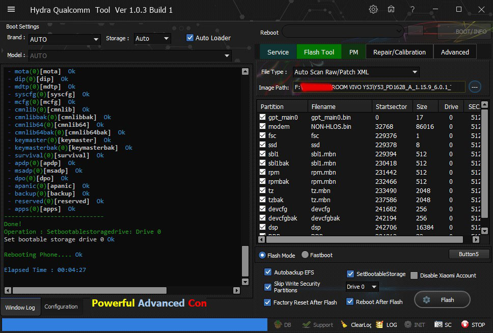

Vivo Y53 (PD1628) Successfully flashed by Hydra Tool
1. Run Qualcomm Tool and choose "Sosc"
2. Choose Brand and Module.
3. Go to "Flash" Tool
4. Choose "Flash files" from its location.
5. Choose "Flash Mode"
6. Choose "Auto backup EFS", "Factory Reset after Flash" and "Reboot after flash"
7. Dissemble device and find test point.
8. Click on "Flash"
9. Connect test points using TWISER or short them.
10. Connect device to computer using USB Data Cable.
11. Wait until the operation is completed.
8. Click on "Flash"
