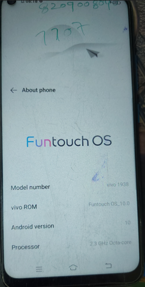

Infinity VIVO Y30 RECOVERY MODE DONE FLASH BY CM2

[FL] : Flashing finished!
Done!
Elapsed: 00:05:00
Reconnect Power/Cable!
