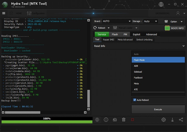

Vivo Y21s imei repair with Hydra Tool
- First Keep Press Boot/Info
To Enable BROM  Mode :
     Method 1    - Bootkey (Vol + - Power) or any combination
     Method 2    - Enable Preloader to brom(crashing Method)
     Method 3    - Test Point Data0 + ground
To Enable Preloader  Mode :
     Method 1    - Just Insert cable
  MTK Port Type   : Flashmode BROM
  FriendlyName    : MediaTek USB Port (COM328)
  Device          : /5&1b591731&0&3
  SymbolicName    : \\?\usb#vid_0e8d&pid_0003#5&1b591731&0&3#{a5dcbf10-6530-11d2-901f-00c04fb951ed}
  Driver Ver      : 01/22/2015,3.0.1504.0
  Service         : wdm_usb
Openning Port [COM328] Ok
Handshaking...Ok
  HwCode          : 0707 {MT6768}
  Hwver           : 0000
  Target config   : E5
  SBC             : 01 (True)
  SLA             : 00 (False)
  DAA             : 04 (True)
  SWJTAG          : 04 (True)
  EPP             : 00 (False)
  CERT            : 00 (False)
  MEMREAD         : 20 (True)
  MEMWRITE        : 40 (True)
  CMD_C8          : 80 (True)
  Connection      : BROM
  HW Subcode      : 8A00
  HW Subcode      : CA00
  SW Ver          : 0000
  ME_ID           : DCD634DCBD2801A3CB1A519FB889C4FA
  SOC_ID          : 1307EF5FCD3253F5F69301A7F6DAEE9CAC6C419424242424442D001D219843C7DA1
Exploiting Device...
Successfully Exploited..
Handshaking...Ok
Seeking preloader address..
Not Found
  Target config   : 00
  SBC             : 00 (False)
  SLA             : 00 (False)
  DAA             : 00 (False)
  SWJTAG          : 00 (False)
  EPP             : 00 (False)
  CERT            : 00 (False)
  MEMREAD         : 00 (False)
  MEMWRITE        : 00 (False)
  CMD_C8          : 00 (False)
  Connection      : BROM
Patching da2 ... Ok
Uploading Stage 1....
Jumping to 0x00200000 Ok 0xC0
Successfully received DA sync
  ONNECTION_AGENT : brom
  DRAM config needed for : 13014E4731433132
Sending auto preloader from dump...
Hydra Auto Preloader Search Enabled..
Hydra will find compatible preloader files...
Found 4 Compatible Preloaders..
1-preloader_k68v1_64_titan.bin...Sending... [DRAM setup passed.] [Ok]
Sending emi data succeeded.
Uploading stage 2...
Successfully uploaded stage 2
  ERAM Size       : 0x0000000000070000-448 KB
  IRAM Size       : 0x0000000100000000-4 GB
  EMMC RPMB Size  : 0x0000000001000000-16 MB
  EMMC USER Size  : 0x0000001D1F000000-116,484 GB
  EMMC CID        : 13014E47314331324C101309D93358F1 - G1C12L
  HW-CODE         : 0x707
  HWSUB-CODE      : 0x8A00
  HW-VERSION      : 0xCA00
  SW-VERSION      : 0x0
  CHIP-EVOLUTION  : 0x1
  DA-VERSION      : 1.0
  Speed           : high-speed
Reading Partition Table ..
Partition Count : 51
  Product        : mssi_64_cn_armv82
  SDK            : 33
  Release        : 13
  ABI            : arm64-v8a
  Locale         : en-US
  Description    : sys_mssi_64_cn_armv82-user 13 TP1A.220624.014 eng.compil.20230428.115111 release-keys
  Display ID     : TP1A.220624.014 release-keys
  Security Patch : 2023-05-01
  StorageType    : mtp
Reading IMEI........
IMEI1 : 86613********
IMEI2 : 86613********
Bootloader Status...
  Bootloader : Locked
Backing up Security..
- preloader(preloader.bin), 512 KB                    = Ok  [preloader_k69v1_64.bin]
  *Creating Scatter file... C:\Hydra Tool\Backup\MTKBKUP\0707_DCD634755j444B1A519FB889C4FA\Auto\070723165009\6768_Android_scatter.txt
- pgpt(pgpt.bin), 32 KB                               = Ok
- nvram(nvram.bin), 64 MB                             = Ok
- nvdata(nvdata.bin), 64 MB                           = Ok
- frp(frp.bin), 1024 KB                               = Ok
- protect1(protect1.bin), 8 MB                        = Ok
- protect2(protect2.bin), 15,242 MB                   = Ok
- persist(persist.bin), 48 MB                         = Ok
- proinfo(proinfo.bin), 3 MB                          = Ok
- nvcfg(nvcfg.bin), 32 MB                             = Ok
- sec1(sec1.bin), 2 MB                                = Ok
- seccfg(seccfg.bin), 8 MB                            = Ok
- lk(lk.bin), 64 MB                                   = Ok
Backup Done!!!
Elapsed Time : 00:01:32

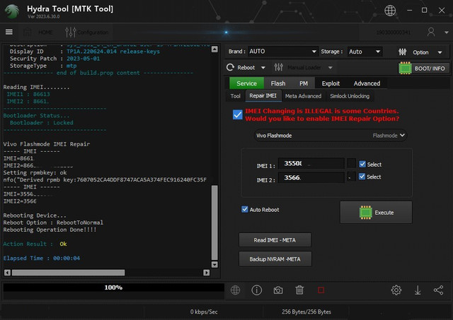

- Repair Vivo Flash Mode
                ***IMEI REPAIR FUNCTION****
                       Vivo Flashmode
  Service         : wdm_usb
  HW-CODE         : 0x707
  HWSUB-CODE      : 0x8A00
  HW-VERSION      : 0xCA00
  SW-VERSION      : 0x0
  DA-VERSION      : 1.0
  Speed           : high-speed
  SDK            : 33
  Release        : 13
  ABI            : arm64-v8a
  Locale         : en-US
  StorageType    : mtp
IMEI1 : 86613*********
IMEI2 : 86613*********
  Bootloader : Locked
Vivo Flashmode IMEI Repair
----- IMEI ------
IMEI=86613***********
IMEI2=8661*********
Setting rpmbkey: ok
nfo("Derived rpmb key:7607052CA4DDF8747ACA5A374FEC9575575F8E727610EB98528C317671D4244
----- IMEI ------
IMEI=3550***********
IMEI2=3566**********
Rebooting Device...
Rebooting Operation Done!!!!
Action Result :  Ok
Elapsed Time : 00:00:04
