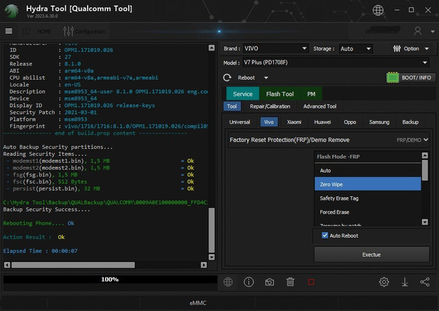

Vivo V7 Plus (PD1708F) FRP Lock Remove with Hydra Tool
               Vivo Service Tool
         Factory Reset Protection(FRP)/Demo Remove
                         Zero Wipe
PreOperation Configuration
Brand : VIVO Model : V7 Plus (PD1708F) Storage : Auto
Loader: 0009a0e100000000_60ba997fef6da9f0_e66632e0_qualcomm_vivo_peek_8953.fhprg
Port  : Auto
FriendlyName :Qualcomm HS-USB QDLoader 9008 (COM6)
SymbolicName :\\?\usb#vid_05c6&pid_9008#5&1f3e3f24&0&9#{a5dcbf10-6530-11d2-901f-00c04fb951ed}
Driver Ver   :08/02/2017,2.1.2.7
Getting device info. [Connected].....
Serial No.: 0xFFD4C203
HW_ID     : 0009A0E100000000
MSM ID    : 0x0009A0E1, SDM450-Qualcomm Snapdragon 450/JAADANAZA
MODEL_ID  : 0x0000
OEM_ID    : 0x0000 - QUALCOMM
PBL Ver   : 00000000
PK HASH   : 60ba997fef6da9f05885fa11f1dd6d2a90d052a257a09c2075d7246cc73c0d43
Firehose Loader[0009a0e100000000_60ba997fef6da9f0_e66632e0_qualcomm_vivo_peek_8953.fhprg]
  Header Type    : OLD
  TargetMSM      : 8953
  Tag            : _peek
  Version        : 3
  Code_size      : 288
  Signature_size : 256
  fhVendor       : VIVO
  Vendor         : QUALCOMM
  OEM_ID         : 0000
  MODEL_ID       : 0000
  SW_ID          : 0000000000000003
  APP_ID         :
  pk_hash        : 60ba997fef6da9f05885fa11f1dd6d2a90d052a257a09c2075d7246cc73c0d43
  OEM_VERSION    : compiler033
  IMAGE_VARIANT  : JAADANAZA
  QC_VERSION     : BOOT.BF.3.3-00221
SaharaBoot... Ok
Sending ..................Ok
Connecting to Firehose...
Ping... Ok
Configuration[FHProt_Auto]......
Identifying Chip....
Ok
Chip Configuration :
MemoryName : eMMC
MaxXMLSizeInBytes : 4096
TargetName : 8953
Version : 1
*** STORAGE DEVICE INFO ***
Memory Type         : eMMC
Block Size in Bytes : 512
Page Size           : 512
Manufacturer ID     : 21
Serial Number       : 1288621082
Firmware Version    : 21
Product Name        : RH64AB
Physical Partitions : 3
Total Logical Blocks:
          Drive [0]  122142720[58,242 GB]
          Drive [1]  8192[4 MB]
          Drive [2]  8192[4 MB]
Protocol : Universal
Running : Ok
Reading GPT[3]
          Drive [0] 56 Items
          Drive [1] 0 Items
          Drive [2] 0 Items
build.prop
  Brand          : vivo
  Vendor         : vivo
  Model          : vivo 1716
  Product        : msm8953_64
  Manufacturer   : vivo
  SDK            : 27
  Release        : 8.1.0
  ABI            : arm64-v8a
  CPU abilist    : arm64-v8a,armeabi-v7a,armeabi
  Locale         : en-US
  Description    : msm8953_64-user 8.1.0 OPM1.171019.026 eng.compil.20210507.122248 release-keys
  Device         : msm8953_64
  Display ID     : OPM1.171019.026 release-keys
  Security Patch : 2021-03-01
  Platform       : msm8953
  Fingerprint    : vivo/1716/1716:8.1.0/OPM1.171019.026/compil05071222:user/release-keys
Auto Backup Security partitions...
Reading Security Items....
- modemst1(modemst1.bin), 1,5 MB                      = Ok
- modemst2(modemst2.bin), 1,5 MB                      = Ok
- fsg(fsg.bin), 1,5 MB                                = Ok
- fsc(fsc.bin), 512 Bytes                             = Ok
- persist(persist.bin), 32 MB                         = Ok
C:\Hydra Tool\Backup\QUALBackup\QUALCOMM\0009A0E100000000_FFD4C203\Auto_Backup\072523210600
Backup Security Success....
Rebooting Phone.... Ok
Action Result :  Ok
Elapsed Time : 00:00:07
