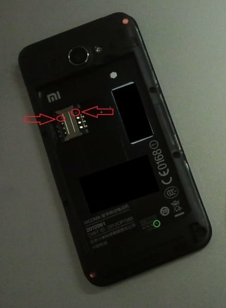

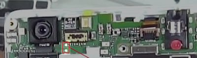

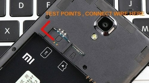

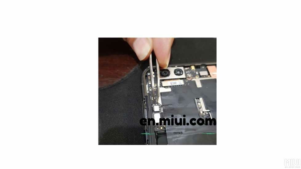

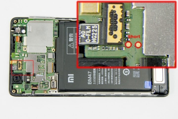

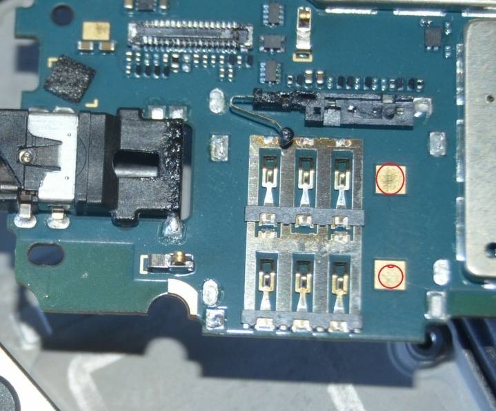

Sollution to bypass mi account

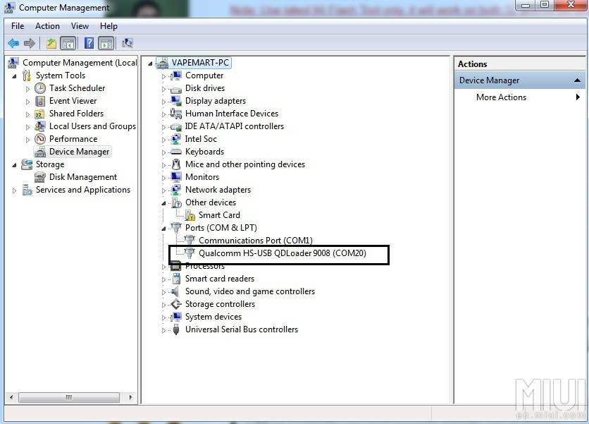

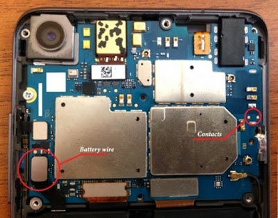

STEPS
1- Remove Battery Ribbon from board
2- Short Pinout
3- Check device manager the device should detect in qloader 9008 port
4- Use Any professional tool to remove Account
CM2+UMT.......etc

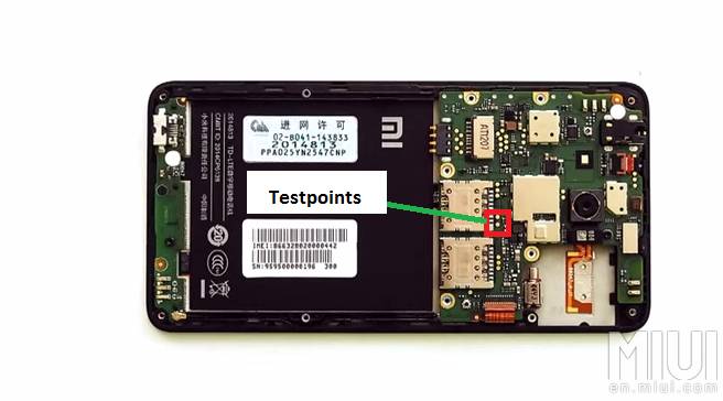

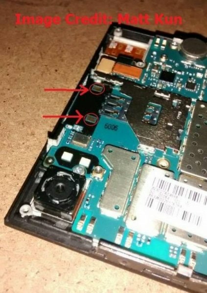

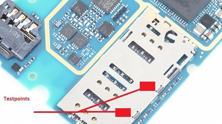

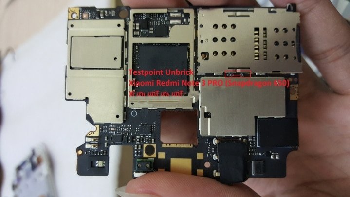

PINOUTS
Mi 5S PLUS
Mi 5S
Mi Note
Redmi 2
Mi 2
Mi 3
Mi 4
Mi 5
Redmi 3 Pro-Prime
3x,S,S Prime
Redmi Note 4G
Redmi 3 Pro
Mi 6
