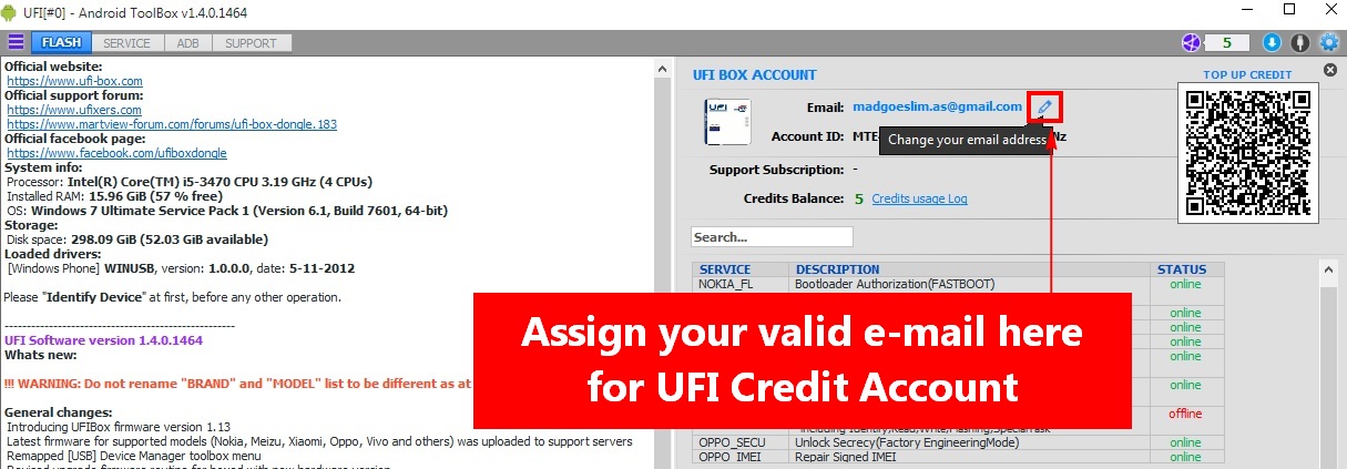

NOTE:
  All features which requires authentication will require credit
  Some remote services are free but are required to have atleast 1 credits in your account
  See "[ACCOUNT]" menu to see latest available services, status and the service cost
  The credits top up system can be accessed directly there
  Payment can be made with Paypal(for International) and GO-PAY(For Indonesia)
  Credits can also be purchased from available resellers

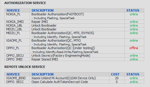

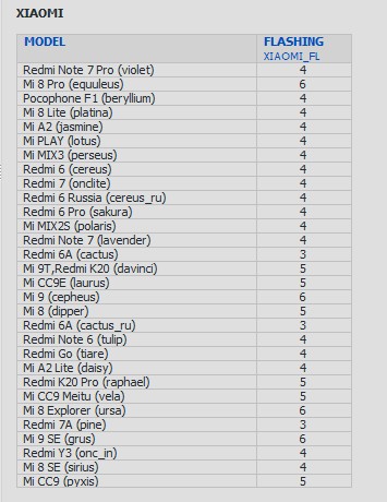

Authorize And Remote Unlock Service via UFI Credit
Supported Models and Cost Service :

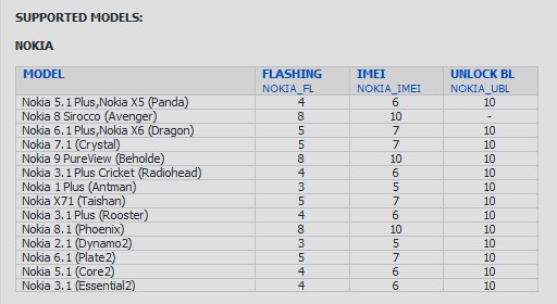

NOKIA :
Flashing (Remove FRP & User Lock
Unlock Bootloader
Repair Imei
XIAOMI :
Flashing
Unlock Bootloader
Unbind Mi Account (Clean Device Only)

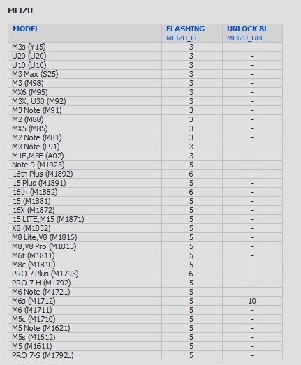

MEIZU :
Flashing
Unlock Bootloader

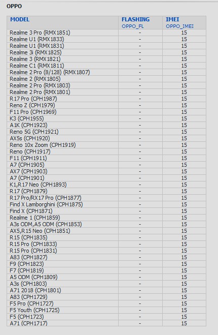

Oppo :
Repair Signed Imei (2018 Models and the latest one)
BUY UFI CREDIT FROM LISTED RESELLER AT THE OFFICIAL SITE
