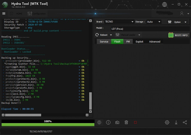

Reading IMEI........
IMEI1 : 35843**********
IMEI2 : 35843**********
Bootloader Status...
  Bootloader : Locked
Backing up Security..
- preloader(preloader.bin), 512 KB                    = Ok  [preloader_ld7_h694.bin]
  *Creating Scatter file... C:\Hydra Tool\Backup\MTKBKUP\0707_45BCB0FF2911A09DF553C71B4442DDE6\Auto\070723122258\6768_Android_scatter.txt
- pgpt(pgpt.bin), 32 KB                               = Ok
- nvram(nvram.bin), 64 MB                             = Ok
- nvdata(nvdata.bin), 64 MB                           = Ok
- frp(frp.bin), 1024 KB                               = Ok
- protect1(protect1.bin), 8 MB                        = Ok
- protect2(protect2.bin), 8 MB                        = Ok
- persist(persist.bin), 48 MB                         = Ok
- proinfo(proinfo.bin), 3 MB                          = Ok
- nvcfg(nvcfg.bin), 32 MB                             = Ok
- sec1(sec1.bin), 2 MB                                = Ok
- seccfg(seccfg.bin), 8 MB                            = Ok
- lk(lk.bin), 2 MB                                    = Ok
Backup Done!!!
Elapsed Time : 00:00:55

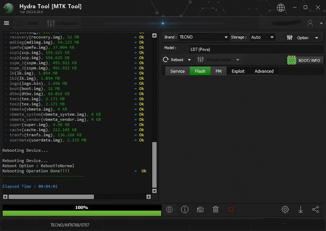

Write Selected Partitions..
- preloader(preloader_ld7_h694.bin), 288.082 KB[Erasing...Ok]  Status  :C0010001 Error= Failed
- tkv(tkv.img), 1024 KB                               = Ok
- recovery(recovery.img), 32 MB                       = Ok
- md1img(md1img.img), 54.123 MB                       = Ok
- spmfw(spmfw.img), 37.094 KB                         = Ok
- scp1(scp.img), 556.625 KB                           = Ok
- scp2(scp.img), 556.625 KB                           = Ok
- sspm_1(sspm.img), 491.922 KB                        = Ok
- sspm_2(sspm.img), 491.922 KB                        = Ok
- lk(lk.img), 1.054 MB                                = Ok
- lk2(lk.img), 1.054 MB                               = Ok
- logo(logo.bin), 1.496 MB                            = Ok
- boot(boot.img), 32 MB                               = Ok
- dtbo(dtbo.img), 69.016 KB                           = Ok
- tee1(tee.img), 2.171 MB                             = Ok
- tee2(tee.img), 2.171 MB                             = Ok
- vbmeta(vbmeta.img), 4 KB                            = Ok
- vbmeta_system(vbmeta_system.img), 4 KB              = Ok
- vbmeta_vendor(vbmeta_vendor.img), 4 KB              = Ok
- super(super.img), 4.98 GB                           = Ok
- cache(cache.img), 212.145 KB                        = Ok
- tranfs(tranfs.img), 136.168 KB                      = Ok
- userdata(userdata.img), 2.235 MB                    = Ok
Rebooting Device...
Rebooting Device...
Rebooting Operation Done!!!!                           =  Ok
Elapsed Time : 00:04:01
