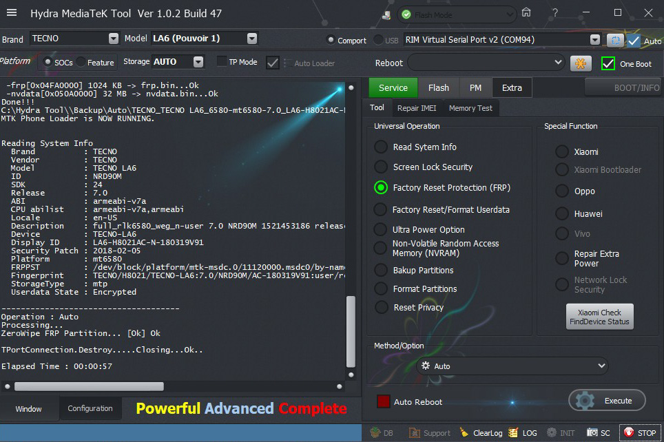

Hydra Techno LA6 Pouvoir 1 FRP successfully Removed by Hydra Tool
546
Brand : TECNO Model : LA6 (Pouvoir 1) Connection : Flash Mode
Connection
-Please wait...
-Connect Phone...
-Found...
-PreLoader...[COM12]
TPortConnection.Create...(COM12)..Opening...Ok
Handshaking...Ok
Identifying Hardware ID.....
BROM CPUID : 6580 (0000)MT6580[6580]
FUSEID : 00001002
FUSEID : 00001002
SECURE VERSION : FF
BL VERSION : 01
BR Secured : 00
Preparing Download Agent..
DA : [Not Exist]
Trying Default 6580.bin
Ver : MTK_AllInOne_DA_v3.3001.2018-09-18.13:22_452898
Init : Loader [1]
Sending : Accepted
Identifying Protocol...
Protocol : Old - eMMC
0000000000000000000000000000
PRMMCCID : 150100464536324D42034CEAD3AC3585
Init Configuration
Running DA 4.2 on BBID : 0x9C Ok
Initializing Loader [2]
Sending Loader [2] Accepted
Reading Flashchip data....
eMMC USER : 0x00000003A3E00000 -14.561 GB
ERAM Size : 0x0000000040000000 -1024 MB
IRAM Size : 0x0000000000020000 -128 KB
UNICAL RID : C0D96CA74F5F5188A38328BF45EF8B97
eMMC CID : 460001154D323645EA4C03428535ACD3
Change to HIGH SPEED...
5A
Connection
-Please wait...
-Found...[COM233]
Reading Partition Table
SIZE[0x00000738] 21 Items > Done
Reading System Info
Brand : TECNO
Vendor : TECNO
Model : TECNO LA6
SDK : 24
Release : 7.0
ABI : armeabi-v7a
Locale : en-US
Description : full_rlk6580_weg_n-user 7.0 NRD90M 1521453186 release-keys
Device : TECNO-LA6
Display ID : LA6-H8021AC-N-180319V91
Security Patch : 2018-02-05
Platform : mt6580
FRPPST : /dev/block/platform/mtk-msdc.0/11120000.msdc0/by-name/frp
Fingerprint : TECNO/H8021/TECNO-LA6:7.0/NRD90M/AC-180319V91:user/release-keys
StorageType : mtp
Userdata State : Encrypted
Autobackup Partitions
-preloader[0x00000000] 512 KB -> preloader.bin...Ok
-> Renaming Preloader.... preloader_rlk6580_weg_n.bin
Creating Scatter file... C:\Hydra Tool\\Backup\Auto\TECNO_TECNO LA6_6580-mt6580-7.0_LA6-H8021AC-N-180319V91_301220175758\MT6580_Android_scatter.txt
-nvram[0x00380000] 5 MB -> nvram.bin...Ok
-frp[0x04FA0000] 1024 KB -> frp.bin...Ok
-nvdata[0x050A0000] 32 MB -> nvdata.bin...Ok
Done!!!
Reading System Info
Brand : TECNO
Vendor : TECNO
Model : TECNO LA6
SDK : 24
Release : 7.0
ABI : armeabi-v7a
Locale : en-US
Device : TECNO-LA6
Platform : mt6580
StorageType : mtp
Operation : Auto
Processing...
ZeroWipe FRP Partition... [Ok] Ok
Elapsed Time : 00:00:57
