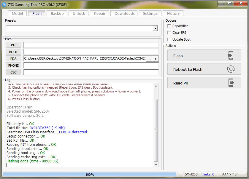

Flash with combination file (Only-aboot-boot-cache)
After flash combination set auto adb enable

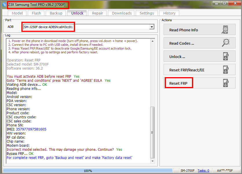

Then frp reset check image
Select j700f
Reset Frp Done

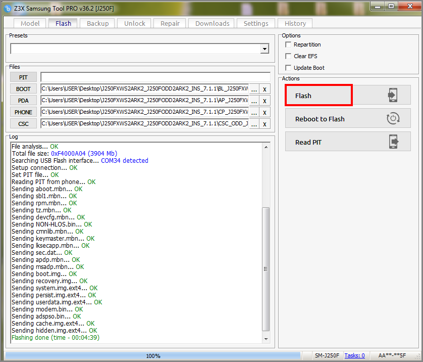

If any other problem face Then Full Flash
