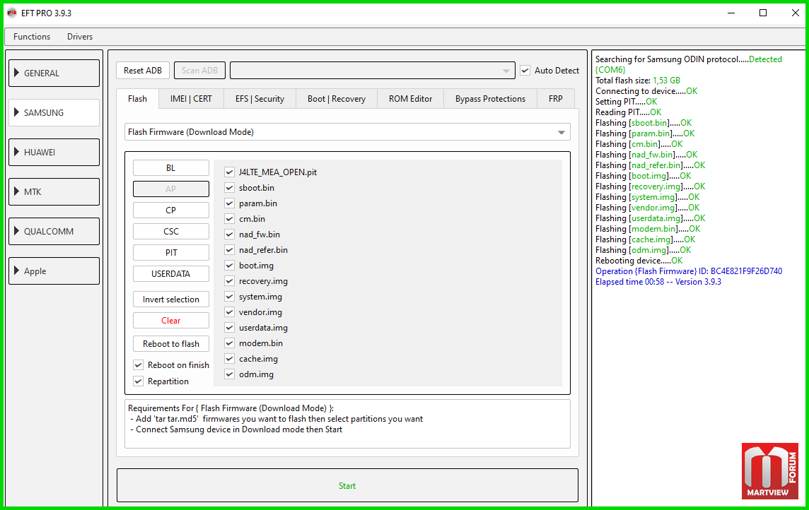

SAMSUNG SM-J400F FRP RESET DONE BY EFT PRO
SAMSUNG SM-J400F FRP RESET PROCESS
  1. FLASH WITH COMBINATION FILE IN (AP) TAB
  2. OPEN PHONE SETTINGS USB DEBUG ON/OEM UNLOCK ON
  3. AFTER THAT ADB AUTO ENABLE

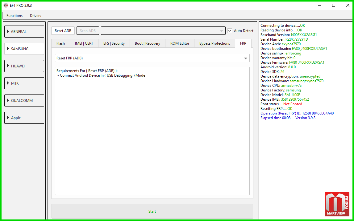

  4. CLICK ON FRP TAB
  5. THEN SELECT "RESET FRP (ADB)"
  6. FRP RESET DONE

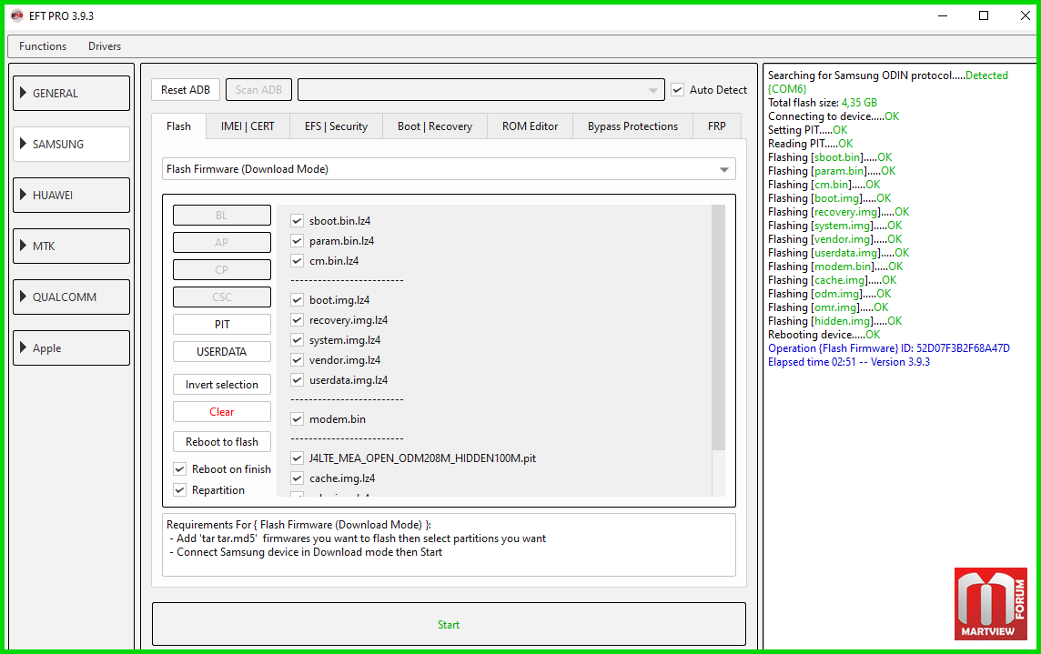

  7. FLASH WITH FULL FARMWARE
  8. MUST FACTORY RESET FROM SETTINGS
DONE & ENJOY..........

  4. CLICK ON FRP TAB
  6. FRP RESET DONE

3/425/6 steps not necessary just flash combination and enabe oem the flash orginal firmware u will done
