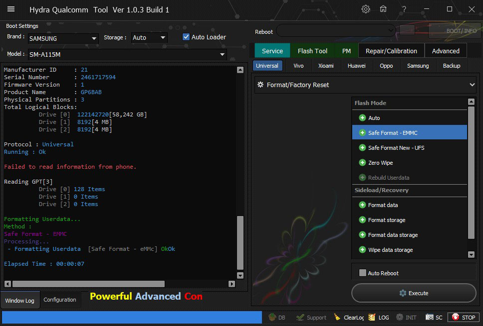

Samsung SM-A115M Safe format EMMC successfully done by Hydra Tool
1. Run Qualcomm tool of Hydra Dongle.
2. Choose Correct Module and Brand.
3. Go to "Service"--> "Univesal"
4. Choose "Format factory / Reset" from drop down menu.
5. Choose "Safe Format EMMC"
6. disassemble device for EMMC Operation.
7. Click "Execute"
8. Wait until the process is completed
