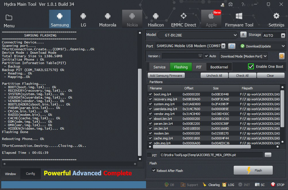

Samsung GT-I9128E successfully flashed by Hydra Tool
1. Run Hydra Main Tool.
2. Choose Samsung and its module.
3. Take Samsung module into download Mode.
4. Connect device with computer using USB Data Cable.
5. Choose the Samsung firmware
6. Tick "Reboot after flash"
7. Click on "Flash".
8. Wait until flashing process is completed.
BR=====================================
SAMSUNG FLASHING
Connecting Device....
Scanning port....
TPortConnection.Create...(COM97)..Opening...Ok
Device Mode : Download Mode
Total Binary Size is 1386.56MB
Initialize Phone : Ok
Partition Information Table(PIT)
- Backup
Backup PIT (COM_TAR2LSI7570) Ok
- Reading.. Ok
- Mapping..Ok
Partition Flashing....
- BOOT(boot.img.lz4)... Ok
- RECOVERY(recovery.img.lz4)... Ok
- SYSTEM(system.img.lz4)... Ok
- USERDATA(userdata.img.lz4)... Ok
- VENDOR(vendor.img.lz4)... Ok
- BOOTLOADER(sboot.bin.lz4)... Ok
- PARAM(param.bin.lz4)... Ok
- CM(cm.bin.lz4)... Ok
- RADIO(modem.bin)... Ok
- CACHE(cache.img.lz4)... Ok
- ODM(odm.img.lz4)... Ok
- OMR(omr.img.lz4)... Ok
- HIDDEN(hidden.img.lz4)... Ok
Flashing Done
Rebooting Phone... Ok
Elapsed Time : 00:01:39
