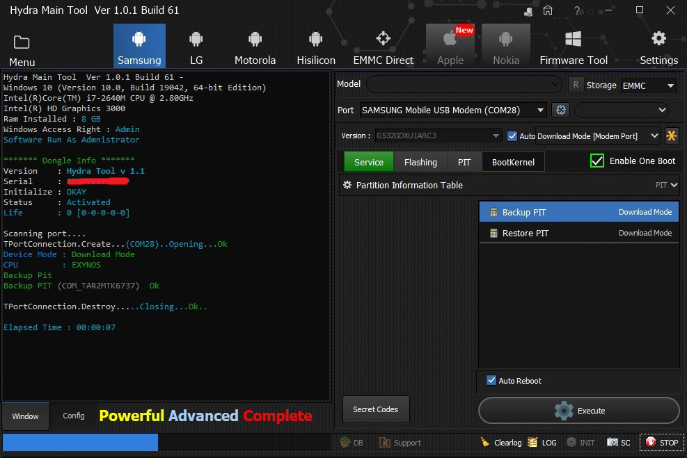

Samsung G532 (J2 Prime) Backing Up PIT file successfully done by Hydra Tool
1. Run Hydra Main Tool.
2. Choose "Samsung" Tab.
3. Put the Device into DOWNLOAD Mode
4. Connect device to the computer using USB Data Cable.
5. Let the computer install device driver.
6. Choose "Port" that takes by Samsung Device.
7. Choose "Service" Tab
8. Choose "Partition Information Table" from drop down menu.
9. Choose “Backup PIT"
10. Tick "Auto Reboot"
11. Click on "Execute"
12. Wait until the operation is completed.
Screen Short:2. Choose "Samsung" Tab.
