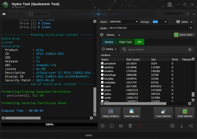

Samsung A11 (SM-A115M) FRP Lock Remove with Hydra Tool
-- keep press boot info

- Go to PM Tab Read Patition
- Select persistent file
- Click Erase

Formatting/Erasing Selected Partitions
- persistent(), 512 KB                                = Ok
Formatting Selected Partitions Done!
Elapsed Time : 00:00:05
