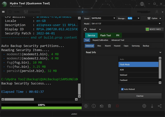

- first keep press boot info
PreOperation Configuration
Brand : SAMSUNG Model : SM-A115F Storage : Auto
Loader: 0009A0E100200000_2a9630bd810ba7b6_5f79caab_SAMSUNG_SAMSUNG CORPORATION_8953.fhprg
Port  : Auto
FriendlyName :Qualcomm HS-USB QDLoader 9008 (COM85)
SymbolicName :\\?\usb#vid_05c6&pid_9008#5&3072a857&0&3#{a5dcbf10-6530-11d2-901f-00c04fb951ed}
Driver Ver   :08/02/2017,2.1.2.7
Getting device info. [Connected].....
Serial No.: 0x659B855B
HW_ID     : 0009A0E100200000
MSM ID    : 0x0009A0E1, SDM450-Qualcomm Snapdragon 450/JAADANAZA
MODEL_ID  : 0x0000
OEM_ID    : 0x0020 - SAMSUNG
PBL Ver   : 00000000
PK HASH   : 2a9630bd810ba7b60ee2750c46a10d3f55e8d0e9b8b36d75632053f4cbaa55ed
Assigned Loader Not Found...
Hydra Enable Auto search Firehose..
#Please wait...
#Search by filename filter.....
#Found 9 Compatible Files ..Found match Firehose...
Firehose Loader[0009a0e100200000_2a9630bd810ba7b6_1db21288_samsung_samsung corporation_8953.fhprg]
  Header Type    : OLD
  TargetMSM      : 8953
  Tag            :
  Version        : 3
  Code_size      : 320
  Signature_size : 256
  fhVendor       : SAMSUNG CORPORATION
  Vendor         : SAMSUNG
  OEM_ID         : 0020
  MODEL_ID       : 0000
  SW_ID          : 0000000100000003
  APP_ID         :
  pk_hash        : 2a9630bd810ba7b60ee2750c46a10d3f55e8d0e9b8b36d75632053f4cbaa55ed
  OEM_VERSION    : 21DH1A12
  IMAGE_VARIANT  : JAADANAZA
  QC_VERSION     : BOOT.BF.3.3.2-00077
SaharaBoot... Ok
Sending ......................Ok
Connecting to Firehose...
Ping... Ok
Configuration[FHProt_Auto]......
Identifying Chip....
Ok
Chip Configuration :
MemoryName : eMMC
MaxXMLSizeInBytes : 4096
TargetName : 8953
Version : 1
*** STORAGE DEVICE INFO ***
Memory Type         : eMMC
Block Size in Bytes : 512
Page Size           : 512
Manufacturer ID     : 21
Serial Number       : 2909065747
Firmware Version    : 1
Product Name        : GD6BMB
Physical Partitions : 3
Total Logical Blocks:
          Drive [0]  61071360[29.121 GB]
          Drive [1]  8192[4 MB]
          Drive [2]  8192[4 MB]
Protocol : Universal
Running : Ok
Reading GPT[3]
          Drive [0] 128 Items
          Drive [1] 0 Items
          Drive [2] 0 Items
build.prop
system
build.prop
  Product        : a11q
  SDK            : 30
  Release        : 11
  ABI            : armeabi-v7a
  CPU abilist    : armeabi-v7a,armeabi
  Locale         : en-GB
  Description    : a11qnsxx-user 11 RP1A.200720.012 A115FXXS2BVD2 release-keys
  Display ID     : RP1A.200720.012.A115FXXS2BVD2
  Security Patch : 2022-04-01
Auto Backup Security partitions...
Reading Security Items....
- modemst1(modemst1.bin), 4 MB                        = Ok
- modemst2(modemst2.bin), 4 MB                        = Ok
- fsg(fsg.bin), 10 MB                                 = Ok
- fsc(fsc.bin), 3.25 MB                               = Ok
- persist(persist.bin), 32 MB                         = Ok
C:\Hydra Tool\Backup\QUALBackup\SAMSUNG\0009A0E100200000_659B855B\Auto_Backup\072023114811
Backup Security Success....
Elapsed Time : 00:02:37

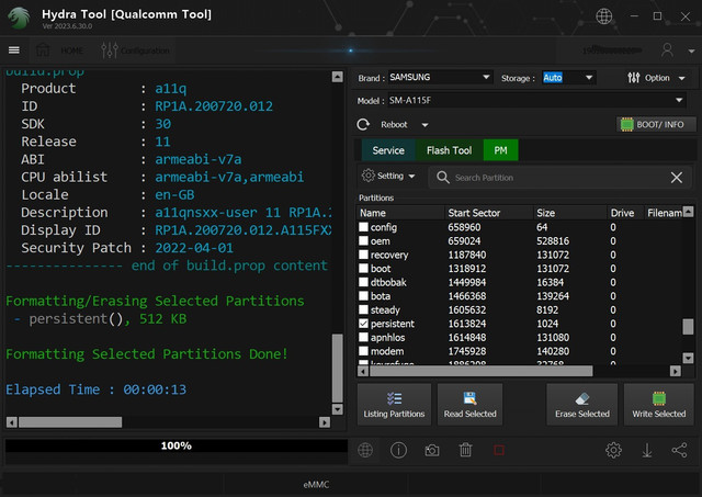

- go to parition tab (PM) and read parition
-- select persistent file and click Erase
                  Partition Manager...
Loader: c:\hydra tool\boot\hfirehose\0009a0e100200000_2a9630bd810ba7b6_1db21288_samsung_samsung corporation_8953.fhprg
Port  : Auto
Getting device info. [Connected].Ok
Device MODE : Firehose
Ping.. Ok
Ok
MemoryName : eMMC
TargetName : 8953
Version : 1
Memory Type         : eMMC
Page Size           : 512
Running : Ok
Reading GPT[3]
          Drive [0] 128 Items
          Drive [1] 0 Items
          Drive [2] 0 Items
build.prop
system
build.prop
  Product        : a11q
  SDK            : 30
  Release        : 11
  ABI            : armeabi-v7a
  Locale         : en-GB
Formatting/Erasing Selected Partitions
- persistent(), 512 KB                                = Ok
Formatting Selected Partitions Done!
Elapsed Time : 00:00:13
