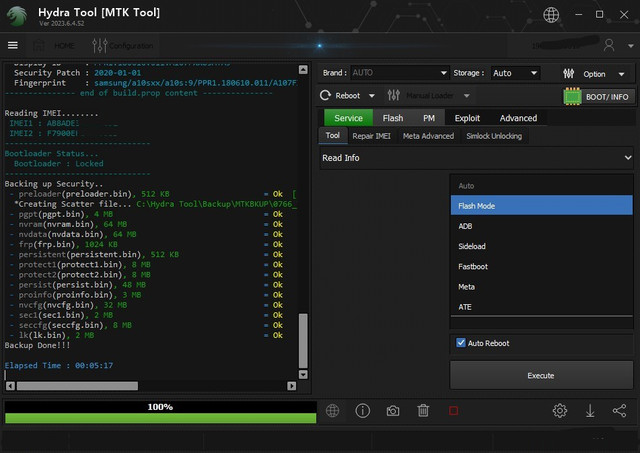

Samsung A10s (SM-A107F) FRP Lock Remove with Hydra Tool
- keep press boot info
- phone connect with test point
To Enable BROM  Mode :
     Method 1    - Bootkey (Vol + - Power) or any combination
     Method 2    - Enable Preloader to brom(crashing Method)
     Method 3    - Test Point Data0 + ground

Reading IMEI........
IMEI1 : AB8ADE*********
IMEI2 : F7900E*********
Bootloader Status...
  Bootloader : Locked
Backing up Security..
- preloader(preloader.bin), 512 KB                    = Ok  [preloader_s96116aa1.bin]
  *Creating Scatter file... C:\Hydra Tool\Backup\MTKBKUP\0766_78CD7ff746DFE21C8B1E3F96EAA7BBF\Auto\071923205444\6765_Android_scatter.txt
- pgpt(pgpt.bin), 4 MB                                = Ok
- nvram(nvram.bin), 64 MB                             = Ok
- nvdata(nvdata.bin), 64 MB                           = Ok
- frp(frp.bin), 1024 KB                               = Ok
- persistent(persistent.bin), 512 KB                  = Ok
- protect1(protect1.bin), 8 MB                        = Ok
- protect2(protect2.bin), 8 MB                        = Ok
- persist(persist.bin), 48 MB                         = Ok
- proinfo(proinfo.bin), 3 MB                          = Ok
- nvcfg(nvcfg.bin), 32 MB                             = Ok
- sec1(sec1.bin), 2 MB                                = Ok
- seccfg(seccfg.bin), 8 MB                            = Ok
- lk(lk.bin), 2 MB                                    = Ok
Backup Done!!!
Elapsed Time : 00:05:17

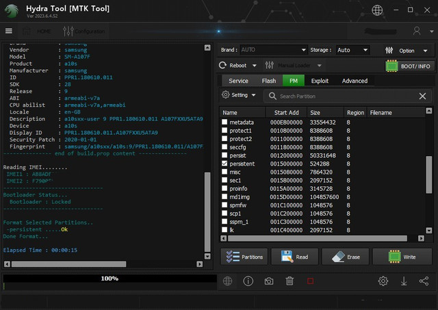

- go to pm tab and read patition files.
- select persistent and erase
                  MTK Partition Manager Function...
IMEI1 : AB8AD***********
IMEI2 : F7900***********
  Bootloader : Locked
Format Selected Partitions..
-persistent .....Ok
Done Format...
Elapsed Time : 00:00:15
