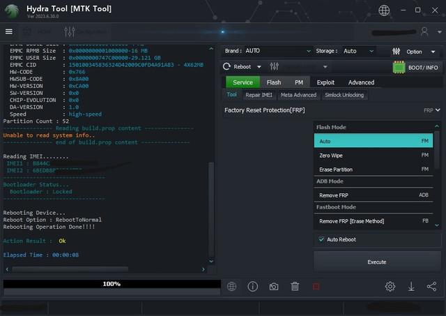

Samsung A04E FRP Lock Remove wuth Hydra Tool
- First keep press boot info
To Enable BROM  Mode :
     Method 1    - Bootkey (Vol + - Power) or any combination
     Method 2    - Enable Preloader to brom(crashing Method)
     Method 3    - Test Point Data0 + ground
To Enable Preloader  Mode :
     Method 1    - Just Insert cable
  MTK Port Type   : Flashmode BROM
  FriendlyName    : MediaTek USB Port (COM19)
  Device          : /6&2c3ff1f8&0&4
  SymbolicName    : \\?\usb#vid_0e8d&pid_0003#6&2c3ff1f8&0&4#{a5dcbf10-6530-11d2-901f-00c04fb951ed}
  Driver Ver      : 01/22/2015,3.0.1504.0
  Service         : wdm_usb
Openning Port [COM19] Ok
Handshaking...
  HwCode          : 0766 {MT6765/MT8768t}
  Hwver           : 0000
  Target config   : E5
  SBC             : 01 (True)
  SLA             : 00 (False)
  DAA             : 04 (True)
  SWJTAG          : 04 (True)
  EPP             : 00 (False)
  CERT            : 00 (False)
  MEMREAD         : 20 (True)
  MEMWRITE        : 40 (True)
  CMD_C8          : 80 (True)
  Connection      : BROM
  HW Subcode      : 8A00
  HW Subcode      : CA00
  SW Ver          : 0000
  ME_ID           : 38350894854CC5E49F46738C9B31BD16
  SOC_ID          : 0633E6C29DEF5E6B23FAF7263D9618BD89008F5D973ADCF9BC3E470CC30B2EBC
Device not yet filterd...
Executing LibUSB Filter..
Device Now Filtered...Restarting Device Port..
Exploiting Device...
Successfully Exploited..
Handshaking...Ok
Starting to dump...
Prel Size : 0x0003C41C
Successfully dump preloader..  [C:\Hydra Tool\Boot\PreloaderDump\preloader_hs04.bin]
  Target config   : 00
  SBC             : 00 (False)
  SLA             : 00 (False)
  DAA             : 00 (False)
  SWJTAG          : 00 (False)
  EPP             : 00 (False)
  CERT            : 00 (False)
  MEMREAD         : 00 (False)
  MEMWRITE        : 00 (False)
  CMD_C8          : 00 (False)
  Connection      : BROM
Patching da2 ... Ok
Uploading Stage 1....
Jumping to 0x00200000 Ok 0xC0
Successfully received DA sync
  ONNECTION_AGENT : brom
  DRAM config needed for : 150100345836324D
Sending auto preloader from dump...  [preloader_hs04.bin]
Sending emi data succeeded.
Uploading stage 2...
Successfully uploaded stage 2
  ERAM Size       : 0x000000000003A000-232 KB
  IRAM Size       : 0x00000000C0000000-3 GB
  EMMC RPMB Size  : 0x0000000001000000-16 MB
  EMMC USER Size  : 0x0000000747C00000-29.121 GB
  EMMC CID        : 150100345836324D42009C0FD4A91A83 - 4X62MB
  HW-CODE         : 0x766
  HWSUB-CODE      : 0x8A00
  HW-VERSION      : 0xCA00
  SW-VERSION      : 0x0
  CHIP-EVOLUTION  : 0x0
  DA-VERSION      : 1.0
  Speed           : high-speed
Reading Partition Table ..
Partition Count : 52
Unable to read system info..
Reading IMEI........
IMEI1 : B844**********
IMEI2 : 6BED**********
Bootloader Status...
  Bootloader : Locked
Backing up Security..
- preloader(preloader.bin), 512 KB                    = Ok  [preloader_hs04.bin]
  *Creating Scatter file... C:\Hydra Tool\Backup\MTKBKUP\0766_38350544CC5E49F46738C9B31BD16\Auto\07204534513\6765_Android_scatter.txt
- pgpt(pgpt.bin), 4 MB                                = Ok
- nvram(nvram.bin), 64 MB                             = Ok
- nvdata(nvdata.bin), 64 MB                           = Ok
- frp(frp.bin), 1024 KB                               = Ok
- persistent(persistent.bin), 512 KB                  = Ok
- protect1(protect1.bin), 8 MB                        = Ok
- protect2(protect2.bin), 8 MB                        = Ok
- persist(persist.bin), 48 MB                         = Ok
- proinfo(proinfo.bin), 3 MB                          = Ok
- nvcfg(nvcfg.bin), 32 MB                             = Ok
- sec1(sec1.bin), 8 MB                                = Ok
- seccfg(seccfg.bin), 8 MB                            = Ok
- lk(lk.bin), 2 MB                                    = Ok
Backup Done!!!
Elapsed Time : 00:00:52
- remove frp and click execute
                      Service Function
               Factory Reset Protection[FRP]
                            Auto
  Service         : wdm_usb
  HW-CODE         : 0x766
  HWSUB-CODE      : 0x8A00
  HW-VERSION      : 0xCA00
  SW-VERSION      : 0x0
  DA-VERSION      : 1.0
  Speed           : high-speed
IMEI1 : B844C9********
IMEI2 : 6BEDB8********
  Bootloader : Locked
Rebooting Device...
Rebooting Operation Done!!!!
Action Result :  Ok
Elapsed Time : 00:00:08
