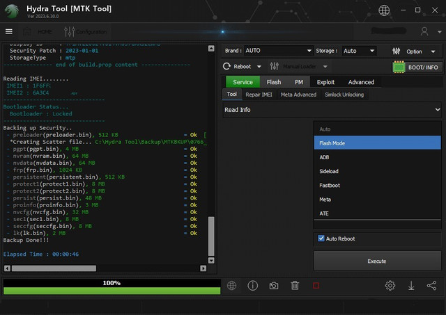

Reading IMEI........
IMEI1 : 1F6FF***********
IMEI2 : 6A3C4***********
Bootloader Status...
  Bootloader : Locked
Backing up Security..
- preloader(preloader.bin), 512 KB                    = Ok  [preloader_hs03s.bin]
  *Creating Scatter file... C:\Hydra Tool\Backup\MTKBKUP\0766_8AAB7EEE$$57A81EE459248D550FE5\Auto\072023090950\6765_Android_scatter.txt
- pgpt(pgpt.bin), 4 MB                                = Ok
- nvram(nvram.bin), 64 MB                             = Ok
- nvdata(nvdata.bin), 64 MB                           = Ok
- frp(frp.bin), 1024 KB                               = Ok
- persistent(persistent.bin), 512 KB                  = Ok
- protect1(protect1.bin), 8 MB                        = Ok
- protect2(protect2.bin), 8 MB                        = Ok
- persist(persist.bin), 48 MB                         = Ok
- proinfo(proinfo.bin), 3 MB                          = Ok
- nvcfg(nvcfg.bin), 32 MB                             = Ok
- sec1(sec1.bin), 8 MB                                = Ok
- seccfg(seccfg.bin), 8 MB                            = Ok
- lk(lk.bin), 2 MB                                    = Ok
Backup Done!!!
Elapsed Time : 00:00:46

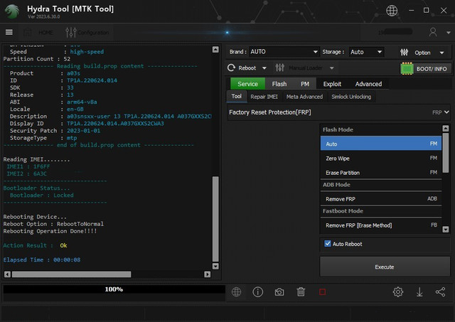

- Remove FRP Lock
                      Service Function
               Factory Reset Protection[FRP]
                            Auto
  MTK Port Type   : Flashmode BROM
  FriendlyName    : MediaTek USB Port_V1632 (COM57)
  Device          : /6&3a34e632&0&1
  SymbolicName    : \\?\usb#vid_0e8d&pid_0003#6&3a34e632&0&1#{a5dcbf10-6530-11d2-901f-00c04fb951ed}
  Driver Ver      : 01/22/2015,3.0.1504.0
  Service         : wdm_usb
Openning Port [COM57] Ok
Reading Partition Table ..
  ERAM Size       : 0x000000000003A000-232 KB
  IRAM Size       : 0x00000000C0000000-3 GB
  EMMC RPMB Size  : 0x0000000001000000-16 MB
  EMMC USER Size  : 0x0000000747C00000-29.121 GB
  EMMC CID        : 15010047583642414200AF5F9B3A481B - GX6BAB
  HW-CODE         : 0x766
  HWSUB-CODE      : 0x8A00
  HW-VERSION      : 0xCA00
  SW-VERSION      : 0x0
  CHIP-EVOLUTION  : 0x0
  DA-VERSION      : 1.0
  Speed           : high-speed
Partition Count : 52
  Product        : a03s
  SDK            : 33
  Release        : 13
  ABI            : arm64-v8a
  Locale         : en-GB
  Description    : a03snsxx-user 13 TP1A.220624.014 A037GXXS2CWA3 release-keys
  Display ID     : TP1A.220624.014.A037GXXS2CWA3
  Security Patch : 2023-01-01
  StorageType    : mtp
IMEI1 : 1F6FF8*********
IMEI2 : 6A3C44*********
  Bootloader : Locked
Rebooting Device...
Rebooting Operation Done!!!!
Action Result :  Ok
Elapsed Time : 00:00:08
