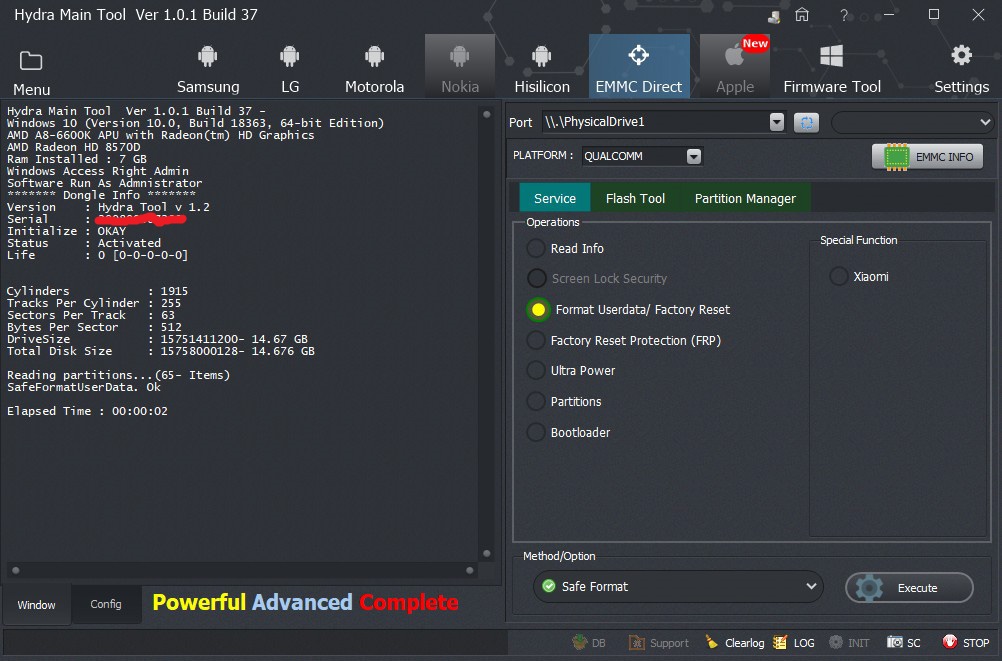

Safe Format user Data using EMMC Direct by Hydra Tool
1. Run Hydra Main Tool.
2. Choose EMMC Direct.
3. Dissemble device, connect with EMMC pin out to the computer.
4. Choose the PORT
5. Choose "Service"--> "Format User Data / Factory Protection (FRP)"
6. Choose "Safe Format" from Method and Option.
7. Click on "Execute"
8. Wait until the process is completed.
4. Choose the PORT
BRCylinders : 1915
Tracks Per Cylinder : 255
Sectors Per Track : 63
Bytes Per Sector : 512
DriveSize : 15751411200- 14.67 GB
Total Disk Size : 15758000128- 14.676 GB
Reading partitions...(65- Items)
SafeFormatUserData. Ok
Elapsed Time : 00:00:02
