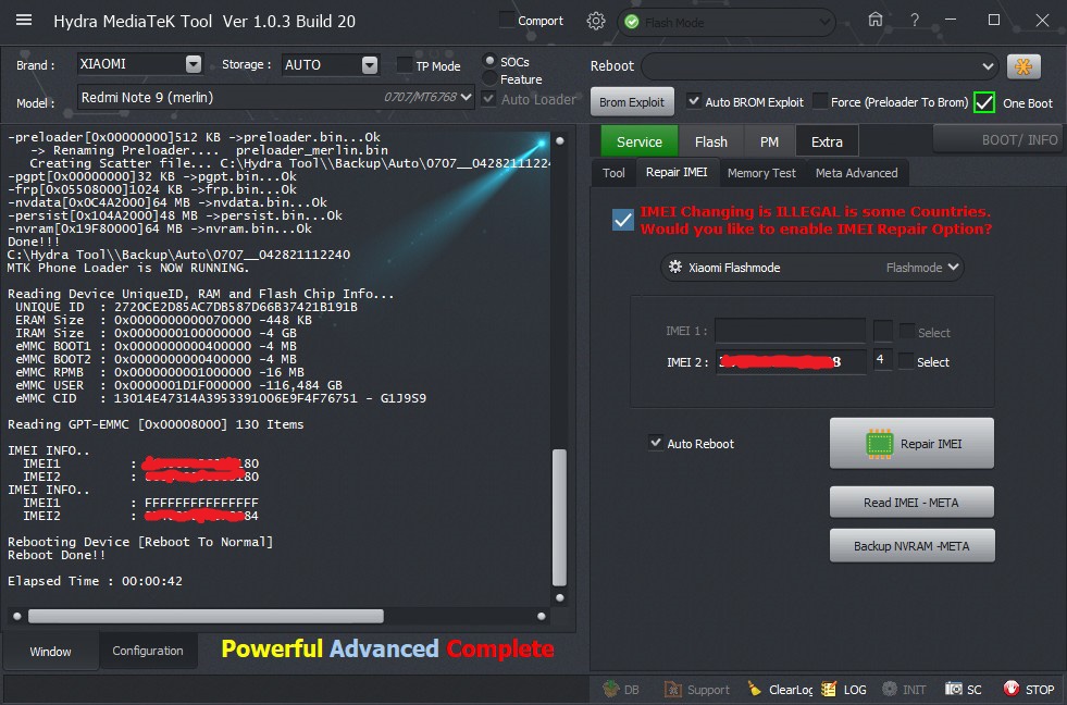

REdmi Note 9 Merlin Second IMEI repaired by Hydra Tool
1. Run Hydra MTK Module, Select Brand and Model
2. Go to Service-->Repair IMEI
3. Choose "Xiaomi Flash Mode" from drop down menu
4. Type correct IMEI as written in battery housing
5. Execute and connect the device to the computer
6. wait until the process is completed.
BR=====================================
***IMEI REPAIR FUNCTION****
Xiaomi Flashmode
FriendlyName :MediaTek USB Port (COM52)
SymbolicName :\??\USB#VID_0E8D&PID_0003#5&1e7d8db7&0&4#{a5dcbf10-6530-11d2-901f-00c04fb951ed}
Handshaking...Ok
Identifying Hardware ID.....
BROM CPUID : 0707MT6768[6768]
getMTKPayloadExploit : 0707
#Executing Exploit..
#SUCCESS..
Handshaking...Ok
FUSEID : 00000000
SECURE VERSION : 00
BL VERSION : FE
BR Secured : E0
Preparing Download Agent..
DA : MT6768_Xiaomi_New.bin
Ver : MTK_AllInOne_DA_v3.3001.2020/07/07.10:10_513994
Init : Loader [1]
Sending : Accepted
Identifying Protocol...
Protocol : New
Synchronization...SYNC
Mode : brom
Preloader Initialization...
Parsing preloader_merlin.bin
Init : Accepted
Execute Secondary Loader
Init : Loader [2]
Executing : SYNC
UNIQUE ID : 2720CE2D85AC7DB587D66B37421B191B
eMMC USER : 0x0000001D1F000000 -116,484 GB
eMMC CID : 13014E47314A3953391006E9F4F76751 - G1J9S9
DA Speed : high-speed
Autobackup Partitions
-> Renaming Preloader.... preloader_merlin.bin
Creating Scatter file... C:\Hydra Tool\\Backup\Auto\0707__042821112240\MT6768_Android_scatter.txt
-frp[0x05508000]1024 KB ->frp.bin...Ok
-nvdata[0x0C4A2000]64 MB ->nvdata.bin...Ok
-persist[0x104A2000]48 MB ->persist.bin...Ok
-nvram[0x19F80000]64 MB ->nvram.bin...Ok
Done!!!
IMEI INFO..
IMEI1 : *************80
IMEI2 : *************80
IMEI INFO..
IMEI1 : FFFFFFFFFFFFFFF
IMEI2 : ***************84
Reboot Done!!
Elapsed Time : 00:00:42
