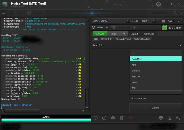

Boot/Info
  MTK Port Type   : Flashmode BROM
  FriendlyName    : MediaTek USB Port (COM45)
  Device          : /7&1882f77d&0&3
  SymbolicName    : \\?\usb#vid_0e8d&pid_0003#7&1882f77d&0&3#{a5dcbf10-6530-11d2-901f-00c04fb951ed}
  Driver Ver      : 07/22/2022,3.0.1511.0
  Service         : wdm_usb
Openning Port [COM45] Ok
Handshaking...Ok
  HwCode          : 0813 {MT6785}
  Hwver           : 0000
  Target config   : E7
  SBC             : 01 (True)
  SLA             : 02 (True)
  DAA             : 04 (True)
  SWJTAG          : 06 (True)
  EPP             : 00 (False)
  CERT            : 00 (False)
  MEMREAD         : 20 (True)
  MEMWRITE        : 40 (True)
  CMD_C8          : 80 (True)
  Connection      : BROM
  HW Subcode      : 8A00
  HW Subcode      : CA00
  SW Ver          : 0000
  ME_ID           : 7B09E10E9D25E50D655DB9C8A2AD1F89
  SOC_ID          : 086F1B57E6C71CE79A60C1A295D645DF68833742FCDA2146189A6A98FE360249
Exploiting Device...
Successfully Exploited..
Handshaking...Ok
Starting to dump...
Prel Size : 0x0004DFC0
Successfully dump preloader..  [C:\Hydra Tool\Boot\PreloaderDump\preloader_begonia.bin]
  Target config   : 00
  SBC             : 00 (False)
  SLA             : 00 (False)
  DAA             : 00 (False)
  SWJTAG          : 00 (False)
  EPP             : 00 (False)
  CERT            : 00 (False)
  MEMREAD         : 00 (False)
  MEMWRITE        : 00 (False)
  CMD_C8          : 00 (False)
  Connection      : BROM
Patching da2 ... Ok
Uploading Stage 1....
Jumping to 0x00200000 Ok 0xC0
Successfully received DA sync
  ONNECTION_AGENT : brom
  DRAM config needed for : 4D54313238474153414F345532312020
Sending auto preloader from dump...  [preloader_begonia.bin]
Sending emi data succeeded.
Uploading stage 2...
Successfully uploaded stage 2
  ERAM Size       : 0x0000000000080000-512 KB
  IRAM Size       : 0x0000000180000000-6 GB
  UFS MID         : 0x4D
  UFS FWVer       : 0x0101
  UFS Blocksize   : 0x0000000000001000-4 KB
  UFS LU0 Size    : 0x0000000000400000-4 MB
  UFS LU1 Size    : 0x0000000000400000-4 MB
  UFS LU2 Size    : 0x0000001DCB000000-119.172 GB
  UFS ID          : 1
  UFS CID         : 4D54313238474153414F34553231202000000000
  HW-CODE         : 0x813
  HWSUB-CODE      : 0x8A00
  HW-VERSION      : 0xCA00
  SW-VERSION      : 0x0
  CHIP-EVOLUTION  : 0x0
  DA-VERSION      : 1.0
  Speed           : high-speed
Reading Partition Table ..
Partition Count : 49
  Brand          : Redmi
  Model          : Redmi Note 8 Pro
  Product        : begonia
  SDK            : 28
  Release        : 9
  ABI            : arm64-v8a
  CPU abilist    : arm64-v8a,armeabi-v7a,armeabi
  Locale         : en-GB
  Description    : begonia-user 9 PPR1.180610.011 V11.0.7.0.PGGMIXM release-keys
  Device         : begonia
  Display ID     : PPR1.180610.011
  Security Patch : 2020-04-01
  Fingerprint    : Redmi/begonia/begonia:9/PPR1.180610.011/V11.0.7.0.PGGMIXM:user/release-keys
  StorageType    : mtp
Reading IMEI........
IMEI1 : 86479**********
IMEI2 : 86479**********
Bootloader Status...
  Bootloader : Locked
Backing up Security..
- preloader(preloader.bin), 512 KB                    = Ok  [preloader_begonia.bin]
  *Creating Scatter file... C:\Hydra Tool\Backup\MTKBKUP\0813_055D25E50D655DB9C8A2AD1F89\Auto\070423181103\6785_Android_scatter.txt
- pgpt(pgpt.bin), 32 KB                               = Ok
- nvram(nvram.bin), 64 MB                             = Ok
- nvdata(nvdata.bin), 64 MB                           = Ok
- frp(frp.bin), 1024 KB                               = Ok
- protect1(protect1.bin), 8 MB                        = Ok
- protect2(protect2.bin), 8 MB                        = Ok
- persist(persist.bin), 70.469 MB                     = Ok
- proinfo(proinfo.bin), 3 MB                          = Ok
- nvcfg(nvcfg.bin), 32 MB                             = Ok
- sec1(sec1.bin), 2 MB                                = Ok
- seccfg(seccfg.bin), 8 MB                            = Ok
- lk(lk.bin), 2 MB                                    = Ok
Backup Done!!!
Elapsed Time : 00:01:04

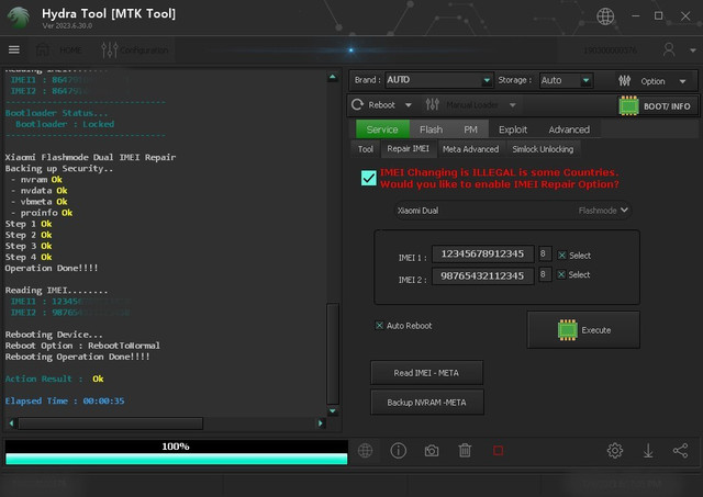

Xiaomi Dual Repair with Flash Mode
                ***IMEI REPAIR FUNCTION****
                        Xiaomi Dual
  Service         : wdm_usb
  UFS MID         : 0x4D
  UFS FWVer       : 0x0101
  UFS ID          : 1
  HW-CODE         : 0x813
  HWSUB-CODE      : 0x8A00
  HW-VERSION      : 0xCA00
  SW-VERSION      : 0x0
  DA-VERSION      : 1.0
  Speed           : high-speed
  Brand          : Redmi
  Product        : begonia
  SDK            : 28
  Release        : 9
  ABI            : arm64-v8a
  Locale         : en-GB
  Device         : begonia
  StorageType    : mtp
  Bootloader : Locked
Xiaomi Flashmode Dual IMEI Repair
- nvram Ok
- nvdata Ok
- vbmeta Ok
- proinfo Ok
Step 1 Ok
Step 2 Ok
Step 3 Ok
Step 4 Ok
Operation Done!!!!
IMEI1 : 12345**********
IMEI2 : 98765**********
Rebooting Device...
Rebooting Operation Done!!!!
Action Result :  Ok
Elapsed Time : 00:00:35
