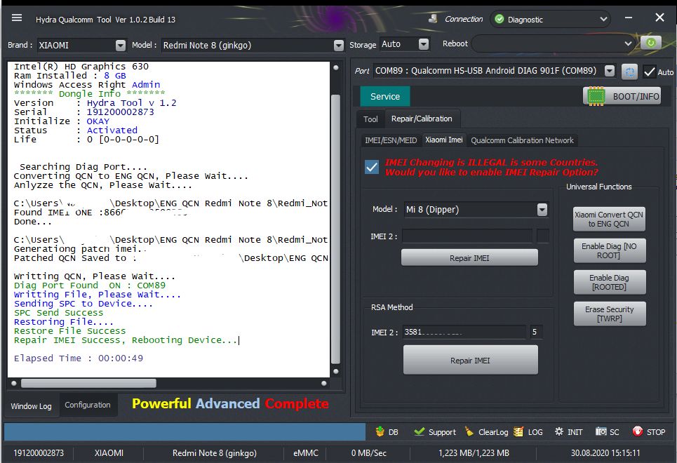

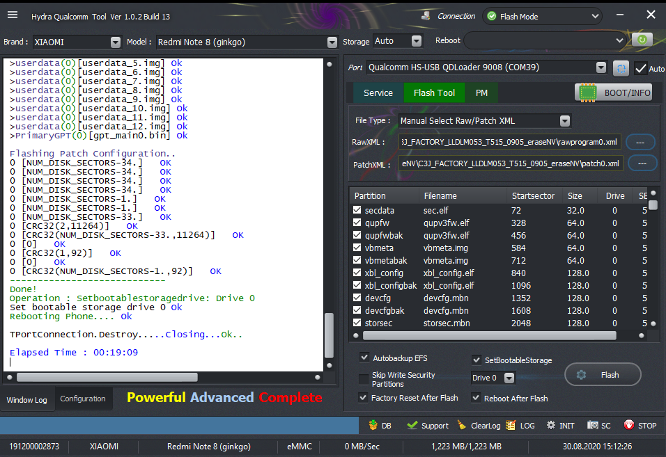

Xiaomi Redmi Note 8 (ginkgo) Repair IMEI Without Root, Without Unlock BL, Without Credit, Without Auth by Hydra Tool steps.
  1. Flash ENG Firmware by EDL Mode with Hydra Dongle
  2. When you flash untick skip security partitions
  3. From RSA IMEI Tab repair imei
Searching EDL Port..[COM39]
TPortConnection.Create...(COM39)..Opening...Ok
Getting device info.......
Serial No.: 0x9F91C3A1
MSM ID : 0x0010A0E1,
PBL Ver : 00000001
PK HASH : 1BEBE3863A6781DB4B01086063007334
DE9E5CA14971C7C4F4358EC9D79CDA46
Firehose Loader[Xiaomi_redminote8_loader.elf]
Initializing SaharaBoot... Ok
Sending ..............................Ok
Connecting to Firehose...
Ping..................... Ok
Configuration........
Identifying Chip....Ok
Chip Configuration :
MemoryName : eMMC
MaxXMLSizeInBytes : 4096
TargetName :
Version : 1
DateTime : Jul 3 2019 - 22:23:56
* STORAGE DEVICE INFO *
Memory Type : eMMC
Block Size in Bytes : 512
Page Size : 512
Manufacturer ID : 19
Serial Number : 322970979
Firmware Version : 4
Product Name : S0J9K8
Physical Partitions : 4
Total Logical Blocks:
Drive [0] 122142720[58,242 GB]
Drive [1] 8192[4 MB]
Drive [2] 8192[4 MB]
Drive [3] 32768[16 MB]
Running : Ok
Reading GPT[4]
<?xml version="1.0" encoding="UTF-8" ?>
<data>
<response value="NAK" rawmode="false" /></data>, Partitions(88 Items) Ok
Phone Information......
Model : Redmi Note 8
Brand : xiaomi
Android Ver : 9
Miui Ver : V11
Manufacturer : Xiaomi
Device : ginkgo
Mod_device : ginkgo_global
Display ID : PKQ1.190616.001
Security Patch : 2020-05-01
Kernel ID : 2020-05-01
Fingerprint : xiaomi/ginkgo/ginkgo:9/PKQ1.190616.001/V11.0.9.0.PCOMIXM:user/release-keys
ro_product_hardware :
sys_hardware_version :
Reading GPT[4]
<data>
Backup Security partitions...
Reading Security Items....
modemst1
modemst2
fsg
C:\Hydra Tool\Backup\Security_Backup\Redmi Note 8__9_Security_083020145227.sec
Backup Security Success....
Flashing Selected Partitions
secdata(0)[sec.elf] Ok
qupfw(0)[qupv3fw.elf] Ok
qupfwbak(0)[qupv3fw.elf] Ok
vbmeta(0)[vbmeta.img] Ok
vbmetabak(0)[vbmeta.img] Ok
xbl_config(0)[xbl_config.elf] Ok
xbl_configbak(0)[xbl_config.elf] Ok
devcfg(0)[devcfg.mbn] Ok
devcfgbak(0)[devcfg.mbn] Ok
storsec(0)[storsec.mbn] Ok
rpm(0)[rpm.mbn] Ok
rpmbak(0)[rpm.mbn] Ok
hyp(0)[hyp.mbn] Ok
hypbak(0)[hyp.mbn] Ok
keymaster(0)[km4.mbn] Ok
keymasterbak(0)[km4.mbn] Ok
cmnlib(0)[cmnlib.mbn] Ok
cmnlib64(0)[cmnlib64.mbn] Ok
cmnlibbak(0)[cmnlib.mbn] Ok
cmnlib64bak(0)[cmnlib64.mbn] Ok
abl(0)[abl.elf] Ok
ablbak(0)[abl.elf] Ok
bluetooth(0)[BTFM.bin] Ok
bluetoothbak(0)[BTFM.bin] Ok
misc(0)[misc.img] Ok
imagefv(0)[imagefv.elf] Ok
imagefvbak(0)[imagefv.elf] Ok
uefisecapp(0)[uefi_sec.mbn] Ok
uefisecappbak(0)[uefi_sec.mbn] Ok
modemst1(0)[dummy.bin] Ok
modemst2(0)[dummy.bin] Ok
xbl(0)[xbl.elf] Ok
xblbak(0)[xbl.elf] Ok
tz(0)[tz.mbn] Ok
tzbak(0)[tz.mbn] Ok
devinfo(0)[devinfo.img] Ok
logfs(0)[logfs_ufs_8mb.bin] Ok
metadata(0)[metadata_1.img] Ok
metadata(0)[metadata_2.img] Ok
metadata(0)[metadata_3.img] Ok
metadata(0)[metadata_4.img] Ok
fsg(0)[fs_image.tar.gz.mbn.img] Ok
dtbo(0)[dtbo.img] Ok
dtbobak(0)[dtbo.img] Ok
dsp(0)[dspso.bin] Ok
dspbak(0)[dspso.bin] Ok
persist(0)[persist.img] Ok
persistbak(0)[persist.img] Ok
boot(0)[boot.img] Ok
bootbak(0)[boot.img] Ok
recovery(0)[recovery.img] Ok
modem(0)[NON-HLOS.bin] Ok
modembak(0)[NON-HLOS.bin] Ok
cache(0)[cache.img] Ok
vendor(0)[vendor_1.img] Ok
vendor(0)[vendor_2.img] Ok
vendor(0)[vendor_3.img] Ok
vendor(0)[vendor_4.img] Ok
vendor(0)[vendor_5.img] Ok
vendor(0)[vendor_6.img] Ok
vendor(0)[vendor_7.img] Ok
vendor(0)[vendor_8.img] Ok
vendor(0)[vendor_9.img] Ok
vendor(0)[vendor_10.img] Ok
vendor(0)[vendor_11.img] Ok
system(0)[system_1.img] Ok
system(0)[system_2.img] Ok
system(0)[system_3.img] Ok
system(0)[system_4.img] Ok
system(0)[system_5.img] Ok
system(0)[system_6.img] Ok
system(0)[system_7.img] Ok
system(0)[system_8.img] Ok
system(0)[system_9.img] Ok
system(0)[system_10.img] Ok
system(0)[system_11.img] Ok
system(0)[system_12.img] Ok
system(0)[system_13.img] Ok
system(0)[system_14.img] Ok
system(0)[system_15.img] Ok
userdata(0)[userdata_1.img] Ok
userdata(0)[userdata_2.img] Ok
userdata(0)[userdata_3.img] Ok
userdata(0)[userdata_4.img] Ok
userdata(0)[userdata_5.img] Ok
userdata(0)[userdata_6.img] Ok
userdata(0)[userdata_7.img] Ok
userdata(0)[userdata_8.img] Ok
userdata(0)[userdata_9.img] Ok
userdata(0)[userdata_10.img] Ok
userdata(0)[userdata_11.img] Ok
userdata(0)[userdata_12.img] Ok
PrimaryGPT(0)[gpt_main0.bin] Ok
0 [NUM_DISK_SECTORS-34.] OK
0 [NUM_DISK_SECTORS-1.] OK
0 [NUM_DISK_SECTORS-33.] OK
0 [CRC32(2,11264)] OK
0 [CRC32(NUM_DISK_SECTORS-33.,11264)] OK
0 [0] OK
0 [CRC32(1,92)] OK
0 [0] OK
Done!
Rebooting Phone.... Ok
Elapsed Time : 00:19:09

Redmi Note 8 IMEI Repair Bootloader Locked, Without Root, Without Credit
Yeah, i did it without any guide
