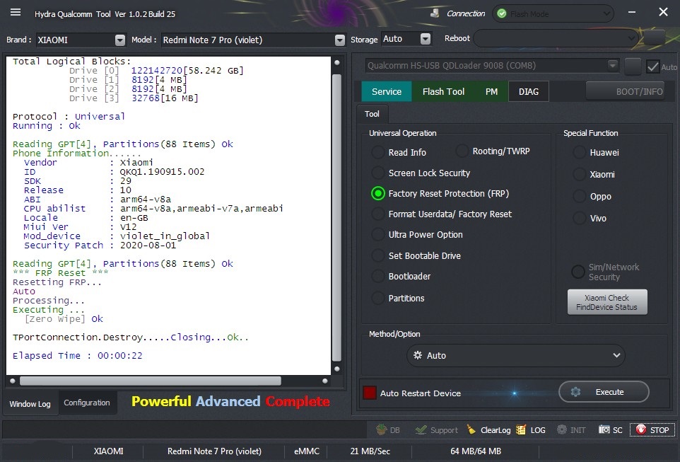

Redmi Note 7 Pro (violet) Android 10 FRP Reset by Hydra Dongle
PreOperation Configuration
Brand : XIAOMI Model : Redmi Note 7 Pro (violet) Storage : Auto
Loader: Xiaomi_Redmi Note 7 Pro_Sdm6150_ddr.elf
Port : Auto
Connection : Flash Mode
Searching EDL Port..[COM8]
TPortConnection.Create...(COM8)..Opening...Ok
Getting device info.......
Serial No.: 0x801AA83C
MSM ID : 0x000950E1, SM6150-Qualcomm Snapdragon 675
PBL Ver : 00000001
PK HASH : 1BEBE3863A6781DB4B01086063007334
DE9E5CA14971C7C4F4358EC9D79CDA46
Firehose Loader[Xiaomi_Redmi Note 7 Pro_Sdm6150_ddr.elf]
SaharaBoot... Ok
Sending ...................................Ok
Connecting to Firehose...
Ping..................... Ok
Configuration.
Signature Request -> bob[cg-6OaQ9RiA44jEKP9HKs0yYp03]
- Hydra Is Online
Identifying Chip....
Ok
Chip Configuration :
MemoryName : eMMC
MaxXMLSizeInBytes : 4096
TargetName :
Version : 1
DateTime : Jul 19 2019 - 01:12:10
*** STORAGE DEVICE INFO ***
Memory Type : eMMC
Block Size in Bytes : 512
Page Size : 512
Manufacturer ID : 21
Serial Number : 2050475080
Firmware Version : 2
Product Name : DH6DAB
Physical Partitions : 4
Total Logical Blocks:
Drive [1] 8192[4 MB]
Drive [2] 8192[4 MB]
Drive [3] 32768[16 MB]
Protocol : Universal
Running : Ok
Reading GPT[4], Partitions(88 Items) Ok
Phone Information......
Vendor : Xiaomi
SDK : 29
Release : 10
ABI : arm64-v8a
Locale : en-GB
Miui Ver : V12
Mod_device : violet_in_global
Security Patch : 2020-08-01
*** FRP Reset ***
Resetting FRP...
Auto
Processing...
Executing ...
[Zero Wipe] Ok
Elapsed Time : 00:00:22
