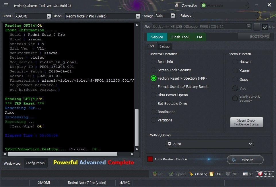

Xiaomi Redmi Note 7 pro violet google account reset EDL Mode with testpoint
PreOperation Configuration
Brand : XIAOMI Model : Redmi Note 7 Pro (violet) Storage : Auto
Loader: Xiaomi_Redmi Note 7 Pro_Sdm6150_ddr.elf
Port : Auto
Connection : Flash Mode
Searching EDL Port..[COM41]
TPortConnection.Create...(COM41)..Opening...Ok
Getting device info..
Device MODE : SAHARA
Connecting to Firehose...
Ping.....
NOTE : FILTERED : <.
NOTE : FILTERED : ?.
NOTE : FILTERED : x.
NOTE : FILTERED : m.
NOTE : FILTERED : l. Ok
Configuration........
Identifying Chip....Ok
Chip Configuration :
MemoryName : eMMC
MaxXMLSizeInBytes : 4096
TargetName :
Version : 1
DateTime : Jul 19 2019 - 01:12:10
* STORAGE DEVICE INFO *
Memory Type : eMMC
Block Size in Bytes : 512
Page Size : 512
Manufacturer ID : 144
Serial Number : 834785305
Firmware Version : 875573296
Product Name : hC8aP>
Physical Partitions : 4
Total Logical Blocks:
Drive [1] 8192[4 MB]
Drive [2] 8192[4 MB]
Drive [3] 8192[4 MB]
Running : Ok
Reading GPT[4]Ok
Phone Information......
Brand : xiaomi
Android Ver : 9
Miui Ver : V11
Manufacturer : Xiaomi
Device : violet
Mod_device : violet_in_global
Display ID : PKQ1.181203.001
Security Patch : 2020-04-01
Kernel ID : 2020-04-01
Fingerprint : xiaomi/violet/violet:9/PKQ1.181203.001/V11.0.9.0.PFHINXM:user/release-keys
ro_product_hardware :
sys_hardware_version :
Reading GPT[4]Ok
* FRP Reset *
Resetting FRP...
Auto
Processing...
Executing ...
[Zero Wipe] Ok
Elapsed Time : 00:00:06
