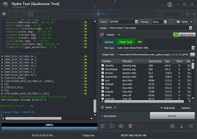

Hydra Redmi Note 7 (lavender) Flashing Done with Hydra Tool
Unlockinfo
Feb 6, 2020
394
435
unlockinfo
- Write firmware done
                  Qualcomm Flashing Function......
PreOperation Configuration
Brand : XIAOMI Model : Redmi Note 7 (lavender) Storage : Auto
Loader: 0008C0E100010000_a7b8b82545a98eca_28f4dc3c_GENERIC_XIAOMI_auth.fhprg
Port  : Auto
FriendlyName :Qualcomm HS-USB QDLoader 9008 (COM126)
SymbolicName :\\?\usb#vid_05c6&pid_9008#7&1e15aaa0&0&4#{a5dcbf10-6530-11d2-901f-00c04fb951ed}

SaharaBoot... Ok
Sending ...............................Ok
Connecting to Firehose...
Ping...... Ok
Configuration[FHProt_Auto]......
Ok

Auto Backup Security partitions...
Reading Security Items....
- modemst1(modemst1.bin), 8 MB                        = Ok
- modemst2(modemst2.bin), 8 MB                        = Ok
- fsg(fsg.bin), 8 MB                                  = Ok
- fsc(fsc.bin), 7.5 KB                                = Ok
- persist(persist.bin), 32 MB                         = Ok
C:\Hydra Tool\Backup\QUALBackup\QUALCOMM\0008C0E100000000_4F0A3B8A\Auto_Backup\080923061749
Backup Security Success....

- vbmeta[0](vbmeta.img), 4 KB                         = Ok
- vbmetabak[0](vbmeta.img), 4 KB                      = Ok
- storsec[0](storsec.mbn), 48.016 KB                  = Ok
- storsecbak[0](storsec.mbn), 48.016 KB               = Ok
- rpm[0](rpm.mbn), 219.57 KB                          = Ok
- rpmbak[0](rpm.mbn), 219.57 KB                       = Ok
- hyp[0](hyp.mbn), 272 KB                             = Ok
- hypbak[0](hyp.mbn), 272 KB                          = Ok
- pmic[0](pmic.elf), 38.961 KB                        = Ok
- pmicbak[0](pmic.elf), 38.961 KB                     = Ok
- cmnlib[0](cmnlib.mbn), 216.984 KB                   = Ok
- cmnlibbak[0](cmnlib.mbn), 216.984 KB                = Ok
- cmnlib64[0](cmnlib64.mbn), 267.703 KB               = Ok
- cmnlib64bak[0](cmnlib64.mbn), 267.703 KB            = Ok
- abl[0](abl.elf), 148 KB                             = Ok
- ablbak[0](abl.elf), 148 KB                          = Ok
- devcfgbak[0](devcfg.mbn), 47.918 KB                 = Ok
- devcfg[0](devcfg.mbn), 47.918 KB                    = Ok
- tz[0](tz.mbn), 1.879 MB                             = Ok
- tzbak[0](tz.mbn), 1.879 MB                          = Ok
- mdtpsecapp[0](mdtpsecapp.mbn), 1.033 MB             = Ok
- mdtpsecappbak[0](mdtpsecapp.mbn), 1.033 MB          = Ok
- keymaster[0](km4.mbn), 309.25 KB                    = Ok
- keymasterbak[0](km4.mbn), 309.25 KB                 = Ok
- bluetooth[0](BTFM.bin), 556 KB                      = Ok
- xbl[0](xbl.elf), 2.452 MB                           = Ok
- xblbak[0](xbl.elf), 2.452 MB                        = Ok
- misc[0](misc.img), 8 KB                             = Ok
- dsp[0](dspso.bin), 16 MB                            = Ok
- mdtp[0](mdtp.img), 16.983 MB                        = Ok
- splash[0](splash.img), 28.937 MB                    = Ok
- persist[0](persist.img), 32 MB Skipped
- modem[0](NON-HLOS.bin), 109.58 MB                   = Ok
- boot[0](boot.img), 64 MB                            = Ok
- recovery[0](recovery.img), 64 MB                    = Ok
- cache[0](cache.img), 120.145 KB                     = Ok
- system[0](system.img), 3.415 GB                     = Ok
- vendor[0](vendor.img), 1.019 GB                     = Ok
- cust[0](cust.img), 217.196 MB                       = Ok
- userdata[0](userdata.img), 198.891 MB               = Ok
- PrimaryGPT[0](gpt_main0.bin), 17 KB                 = Ok
0 [NUM_DISK_SECTORS-34.]                               = Ok
0 [NUM_DISK_SECTORS-1.]                                = Ok
0 [NUM_DISK_SECTORS-33.]                               = Ok
0 [CRC32(2,8704)]                                      = Ok
0 [CRC32(NUM_DISK_SECTORS-33.,8704)]                   = Ok
0 [0]                                                  = Ok
0 [CRC32(1,92)]                                        = Ok
0 [0]                                                  = Ok
0 [CRC32(NUM_DISK_SECTORS-1.,92)]                      = Ok
Rebooting Phone.... Ok
Elapsed Time : 00:05:51
