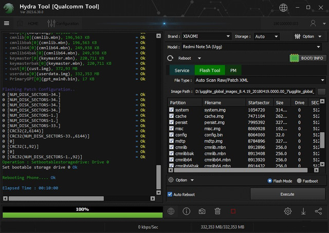

Hydra Redmi Note 5A Flashing done with Hydra Tool
Rashi Hydra Tool
Feb 3, 2021
362
376
Hydra Team
                  Qualcomm Flashing Function......
PreOperation Configuration
Brand : XIAOMI Model : Redmi Note 5A (Ugg) Storage : Auto
Loader: 000560e100000000_57158eaf1814d78f_01740d29_qualcomm_xiaomi_peek_8917.fhprg
Port  : Auto
FriendlyName :Qualcomm HS-USB QDLoader 9008 (COM4)
SymbolicName :\\?\usb#vid_05c6&pid_9008#5&2551f1d&0&1#{a5dcbf10-6530-11d2-901f-00c04fb951ed}
Driver Ver   :08/02/2017,2.1.2.7
Getting device info. [Connected].....
Serial No.: 0x06189B76
HW_ID     : 000560E100000000
MSM ID    : 0x000560E1, MSM8917-Qualcomm Snapdragon 425/LAADANAZA
MODEL_ID  : 0x0000
OEM_ID    : 0x0000 - QUALCOMM
PBL Ver   : 00000000
PK HASH   : 57158eaf1814d78fd2b3105ece4db18a817a08ac664a5782a925f3ff8403d39a
Firehose Loader[000560e100000000_57158eaf1814d78f_01740d29_qualcomm_xiaomi_peek_8917.fhprg]
  Header Type    : OLD
  TargetMSM      : 8917
  Tag            : _peek
  Version        : 3
  Code_size      : 288
  Signature_size : 256
  fhVendor       : XIAOMI
  Vendor         : QUALCOMM
  OEM_ID         : 0000
  MODEL_ID       : 0000
  SW_ID          : 0000000000000003
  APP_ID         :
  pk_hash        : 57158eaf1814d78fd2b3105ece4db18a817a08ac664a5782a925f3ff8403d39a
  OEM_VERSION    : c3-miui-ota-bd102.bj
  IMAGE_VARIANT  : LAADANAZA
  QC_VERSION     : BOOT.BF.3.3-00214
SaharaBoot... Ok
Sending ...................Ok
Connecting to Firehose...
Ping... Ok
Configuration[FHProt_Auto]......
Ok
Chip Configuration :
MemoryName : eMMC
MaxXMLSizeInBytes : 4096
TargetName : 8917
Version : 1
*** STORAGE DEVICE INFO ***
Memory Type         : eMMC
Block Size in Bytes : 512
Page Size           : 512
Manufacturer ID     : 144
Serial Number       : 774388623
Firmware Version    : 165
Product Name        : HAG4a2
Physical Partitions : 3
Total Logical Blocks:
          Drive [0]  30777344[14,676 GB]
          Drive [1]  8192[4 MB]
          Drive [2]  8192[4 MB]
Protocol : Universal
Running : Ok
Reading GPT[3]
          Drive [0] 48 Items
          Drive [1] 0 Items
          Drive [2] 0 Items
build.prop
  Brand          : xiaomi
  Product        : ugglite
  SDK            : 25
  Release        : 7.1.2
  ABI            : arm64-v8a
  CPU abilist    : arm64-v8a,armeabi-v7a,armeabi
  Locale         : en-GB
  Description    : ugglite-user 7.1.2 N2G47H V10.3.1.0.NDFMIXM release-keys
  Device         : ugglite
  Display ID     : N2G47H
  Security Patch : 2019-06-01
  Platform       : msm8937
  Fingerprint    : xiaomi/ugglite/ugglite:7.1.2/N2G47H/V10.3.1.0.NDFMIXM:user/release-keys
Auto Backup Security partitions...
Reading Security Items....
- modemst1(modemst1.bin), 1,5 MB                      = Ok
- modemst2(modemst2.bin), 1,5 MB                      = Ok
- fsg(fsg.bin), 1,5 MB                                = Ok
- fsc(fsc.bin), 512 Bytes                             = Ok
- persist(persist.bin), 32 MB                         = Ok
C:\Hydra Tool\Backup\QUALBackup\QUALCOMM\000560E100000000_06189B76\Auto_Backup\070723204932
Backup Security Success....
C:\Hydra Tool\Backup\QUALBackup\QUALCOMM\000560E100000000_06189B76\Auto_Backup\070723204937
- sbl1[0](sbl1.mbn), 337,754 KB                       = Ok
- sbl1bak[0](sbl1.mbn), 337,754 KB                    = Ok
- rpm[0](rpm.mbn), 180,398 KB                         = Ok
- rpmbak[0](rpm.mbn), 180,398 KB                      = Ok
- tz[0](tz.mbn), 1,464 MB                             = Ok
- tzbak[0](tz.mbn), 1,464 MB                          = Ok
- devcfg[0](devcfg.mbn), 59,465 KB                    = Ok
- devcfgbak[0](devcfg.mbn), 59,465 KB                 = Ok
- dsp[0](adspso.bin), 16 MB                           = Ok
- splash[0](splash.img), 351,826 KB                   = Ok
- aboot[0](emmc_appsboot.mbn), 588,773 KB             = Ok
- abootbak[0](emmc_appsboot.mbn), 588,773 KB          = Ok
- boot[0](boot.img), 31,499 MB                        = Ok
- recovery[0](recovery.img), 32,829 MB                = Ok
- system[0](system.img), 2,244 GB                     = Ok
- cache[0](cache.img), 6,102 MB                       = Ok
- persist[0](persist.img), 4,606 MB Skipped
- misc[0](misc.img), 8 KB                             = Ok
- config[0](config.bin), 32 KB Skipped
- mdtp[0](mdtp.img), 13,111 MB                        = Ok
- cmnlib[0](cmnlib.mbn), 196,563 KB                   = Ok
- cmnlibbak[0](cmnlib.mbn), 196,563 KB                = Ok
- cmnlib64[0](cmnlib64.mbn), 249,938 KB               = Ok
- cmnlib64bak[0](cmnlib64.mbn), 249,938 KB            = Ok
- keymaster[0](keymaster.mbn), 220,711 KB             = Ok
- keymasterbak[0](keymaster.mbn), 220,711 KB          = Ok
- cust[0](cust.img), 372,93 MB                        = Ok
- userdata[0](userdata.img), 332,353 MB               = Ok
- PrimaryGPT[0](gpt_main0.bin), 17 KB                 = Ok
0 [NUM_DISK_SECTORS-34.]                               = Ok
0 [NUM_DISK_SECTORS-1.]                                = Ok
0 [NUM_DISK_SECTORS-33.]                               = Ok
0 [CRC32(2,6144)]                                      = Ok
0 [CRC32(NUM_DISK_SECTORS-33.,6144)]                   = Ok
0 [0]                                                  = Ok
0 [CRC32(1,92)]                                        = Ok
0 [0]                                                  = Ok
0 [CRC32(NUM_DISK_SECTORS-1.,92)]                      = Ok
Rebooting Phone.... Ok
Elapsed Time : 00:10:00
