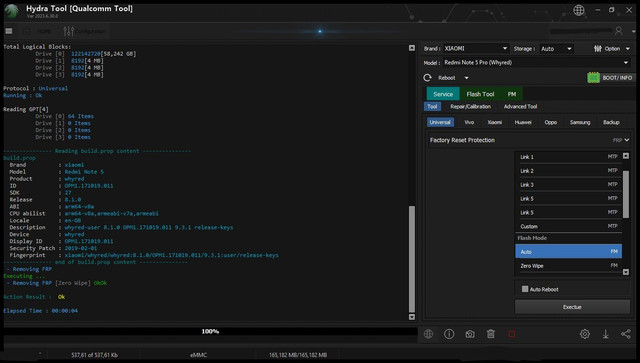

Redmi Note 5 Pro FRP Lock Remove with Hydra Tool
- FRP LOCK REMOVE
                   Qualcomm Service Tool
                  Factory Reset Protection
                            Auto
PreOperation Configuration
Brand  XIAOMI Model  Redmi Note 5 Pro (Whyred) Storage  Auto
Loader 0008C0E100010000_a7b8b82545a98eca_28f4dc3c_GENERIC_XIAOMI_auth.fhprg
Port   Auto
FriendlyName Qualcomm HS-USB QDLoader 9008 (COM15)
SymbolicName usb#vid_05c6&pid_9008#6&182a12da&0&6#{a5dcbf10-6530-11d2-901f-00c04fb951ed}
Driver Ver   07082015,2.1.2.0
Getting device info. [Connected].Ok
Device MODE  Firehose
Connecting to Firehose...
Ping...... Ok
Configuration[FHProt_Auto]......
Ok
Chip Configuration
MemoryName  eMMC
MaxPayloadSizeToTargetInBytes  1048576
MaxPayloadSizeToTargetInBytesSupported  1048576
MaxPayloadSizeFromTargetInBytes  4096
MaxXMLSizeInBytes  4096
TargetName  MSM8996
Version  1
DateTime  Aug  2 2018 - 222753
STORAGE DEVICE INFO
Memory Type          eMMC
Block Size in Bytes  512
Page Size            512
Manufacturer ID      144
Serial Number        1234634018
Firmware Version     162
Product Name         HCG8a4
Physical Partitions  4
Total Logical Blocks
          Drive [0]  122142720[58,242 GB]
          Drive [1]  8192[4 MB]
          Drive [2]  8192[4 MB]
          Drive [3]  8192[4 MB]
Protocol  Universal
Running  Ok
Reading GPT[4]
          Drive [0] 64 Items
          Drive [1] 0 Items
          Drive [2] 0 Items
          Drive [3] 0 Items
build.prop
  Brand           xiaomi
  Model           Redmi Note 5
  Product         whyred
  ID              OPM1.171019.011
  SDK             27
  Release         8.1.0
  ABI             arm64-v8a
  CPU abilist     arm64-v8a,armeabi-v7a,armeabi
  Locale          en-GB
  Description     whyred-user 8.1.0 OPM1.171019.011 9.3.1 release-keys
  Device          whyred
  Display ID      OPM1.171019.011
  Security Patch  2019-02-01
  Fingerprint     xiaomiwhyredwhyred8.1.0OPM1.171019.0119.3.1userrelease-keys
- Removing FRP
Executing ...
- Removing FRP [Zero Wipe] OkOk
Action Result   Ok
Elapsed Time  000004
