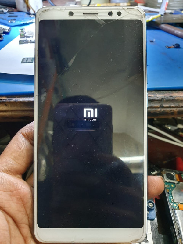

Redmi note 5 pro Dead by flashing fixed

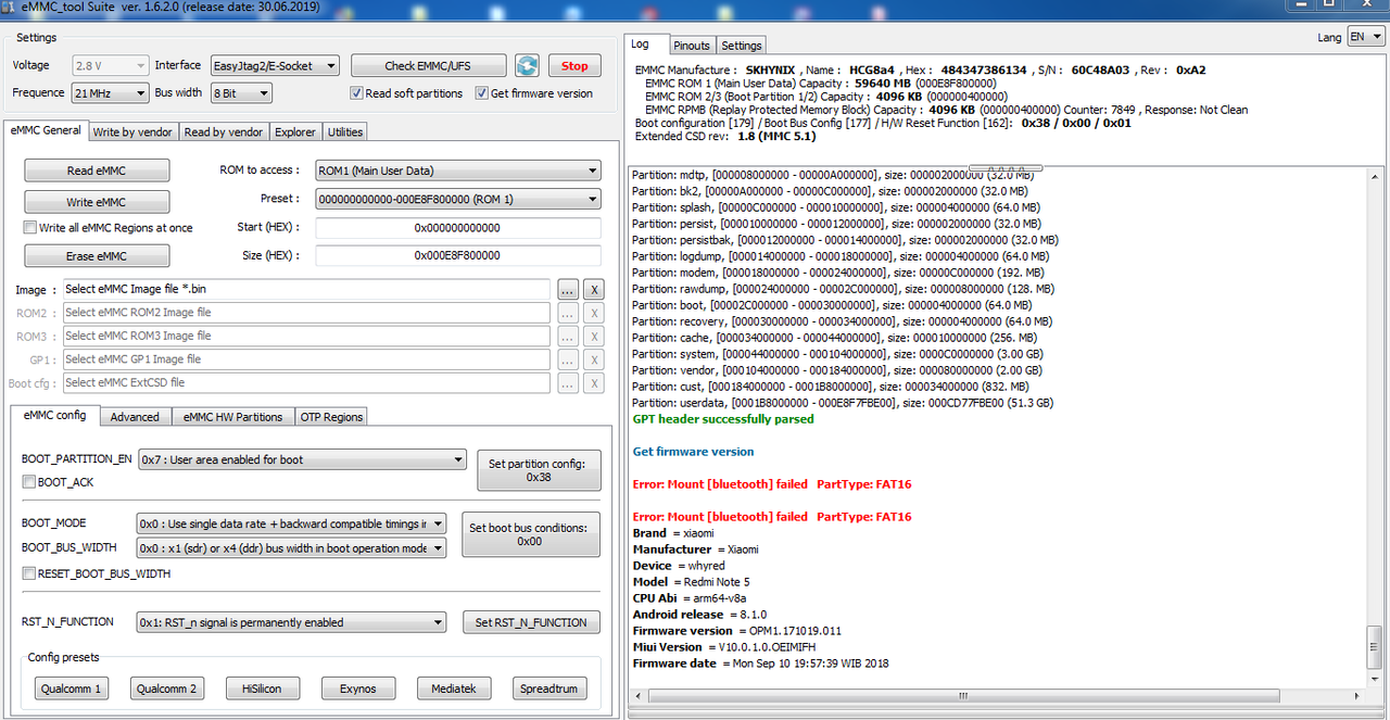

Read Info
QcFire Logs
Operation : Read Information
Checking for existing devices...Not Found
Found Port : Qualcomm HS-USB QDLoader 9008 (COM9)
Driver Info : Qualcomm Incorporated, qcusbser.sys, 2.1.2.2
Connecting to phone...OK
Waiting for response...Ignored
Init Handshake Sequence...OK
Hardware ID : E1C00C00 [8996] 00000000
OPK_DATA : F7337FE47B192EF4D1BA34CB4E879F0C6B771D06D2DE87BF21F65BA3303834E1
Initializing Protocol...OK
Preparing Loader...Done
Sending Loader [8996_016]...Done
Executing Loader...OK
Detecting Chip Type...OK
Hardware : MSM8996, eMMC, 64 GB
LU Count : 1 [0x0747C000]
Payload Info : In: 65536 [4096], Out: 131072, Sector Size: 512
Reading Partition Table...OK
Device : Xiaomi Redmi Note 5 [whyred]
Software : OPM1.171019.011, V10.3.1.0.OEIMIXM [Fri Apr 26 15:54:32 WIB 2019]
Android Ver. : 8.1.0
Patch Level : 2019-04-01
USERDATA : Encrypted
You can use DISABLE LOCKS to Disable Pin/Pattern/Password WITHOUT Data Loss.
Operation Finished.
QcFire Ver. 4.7

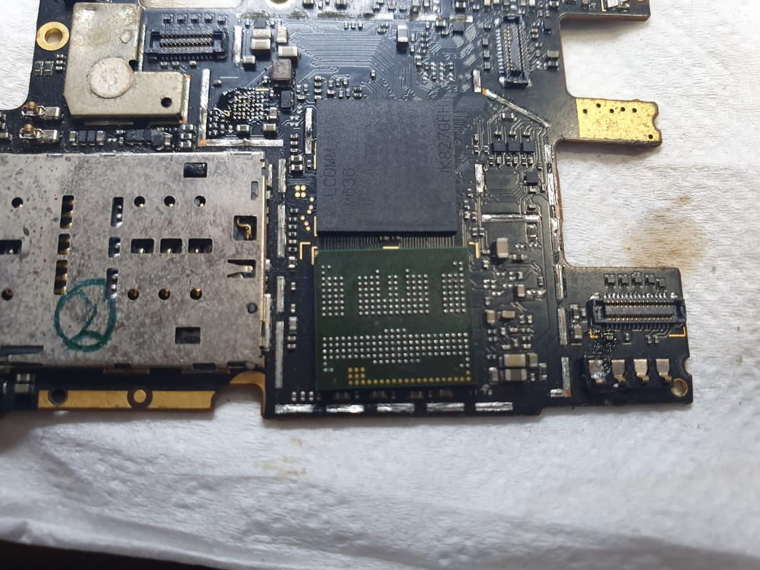

Removed Emmc
EasyJtag Logs After programming
Work Done
