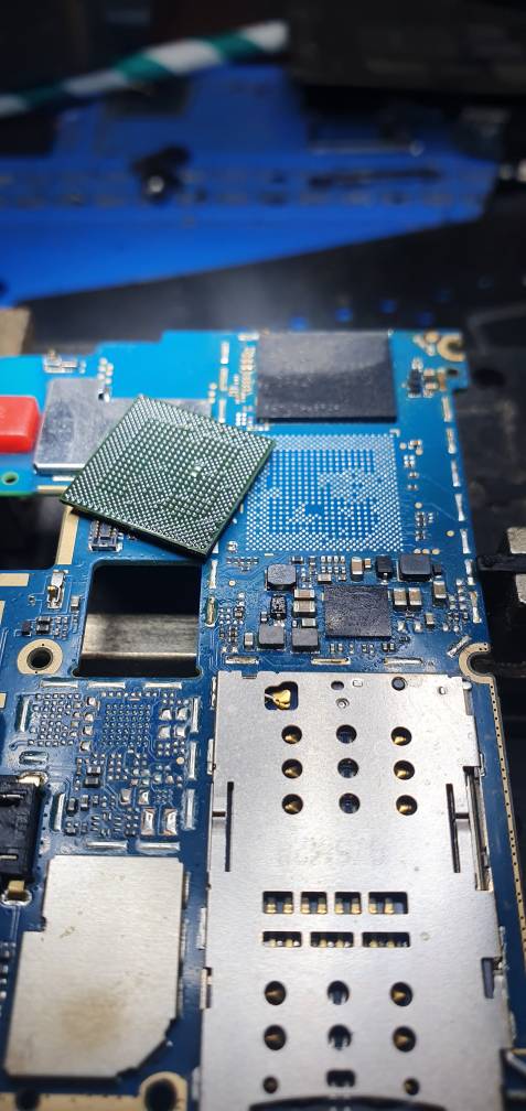

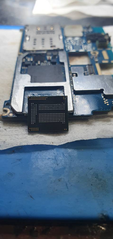

#Jerry_style #Delhi_Emmc
Received Dead [emoji2]
Dealer said red light blinking.[emoji869]
Tp Qualcomm port not detecting
Directly Removed Emmc making Qualcomm port.[emoji857]
Reballed Emmc same fault.
I thought ram issue so Replaced with 3gb ram emmc from another Note 4
Then too same not making any port with TP.[emoji849]
Directly cpu reball Phone working now
Replaced back 4g ram emmc
Atlast Job done.[emoji2956][emoji2956][emoji2956]
