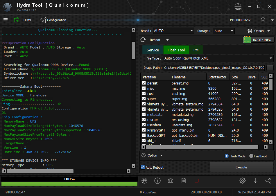

Redmi Note 11 The System Has Been Destroyed Problem Solved !
BY
Read Info
Qualcomm Service Tool
Read Info
Flash Mode
PreOperation Configuration
Brand : AUTO Model : AUTO Storage : Auto
Loader: Auto
Port : Auto
FriendlyName :Qualcomm HS-USB QDLoader 9008 (COM13)

Qualcomm Flashing Function...
Loader: Auto
Port : Auto
SymbolicName :\\?\usb#vid_05c6&pid_9008#5&15c311e1&0&1#{a5dcbf10-6530-11d2-901f-00c04fb951ed}
Driver Ver :12/17/2018,2.1.3.5
=========Sahara Boot=========
Initialize...OkOk
Device MODE : Firehose
Connecting to Firehose...
Ping...................... Ok
Configuration[FHProt_Auto]........
Ok

Operation : Setbootablestoragedrive: Drive 1
Set bootable storage drive 1 Ok
Rebooting Phone.... Ok
Elapsed Time : 00:06:40
