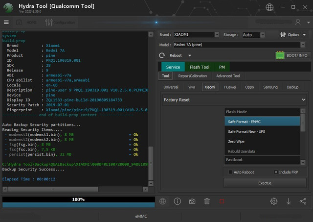

- First keep press boot info
PreOperation Configuration
Brand : XIAOMI Model : Redmi 7A (pine) Storage : Auto
Loader: 000BF0E100720000_57158eaf1814d78f_e551cac5_XIAOMI_auth_peek_8937.fhprg
Port  : Auto
FriendlyName :Qualcomm HS-USB QDLoader 9008 (COM3)
SymbolicName :\\?\usb#vid_05c6&pid_9008#6&3ae11b61&0&4#{a5dcbf10-6530-11d2-901f-00c04fb951ed}
Driver Ver   :12/17/2018,2.1.3.5
Getting device info. [Connected].....
Serial No.: 0x94BE109D
HW_ID     : 000BF0E100720000
MSM ID    : 0x000BF0E1, SDM439-Qualcomm Snapdragon 439/FAADANAZA
MODEL_ID  : 0x0000
OEM_ID    : 0x0072 - XIAOMI
PBL Ver   : 00000000
PK HASH   : 57158eaf1814d78fd2b3105ece4db18a817a08ac664a5782a925f3ff8403d39a
Firehose Loader[000BF0E100720000_57158eaf1814d78f_e551cac5_XIAOMI_auth_peek_8937.fhprg]
  Header Type    : OLD
  TargetMSM      : 8937
  Tag            : _auth_peek
  Version        : 3
  Code_size      : 320
  Signature_size : 256
  fhVendor       : XIAOMI
  Vendor         : XIAOMI
  OEM_ID         : 0072
  MODEL_ID       : 0000
  SW_ID          : 0000000100000003
  APP_ID         :
  pk_hash        : 57158eaf1814d78fd2b3105ece4db18a817a08ac664a5782a925f3ff8403d39a
  OEM_VERSION    : c4-miui-ota-bd104.bj
  IMAGE_VARIANT  : FAADANAZA
  QC_VERSION     : BOOT.BF.3.3.2-00073
SaharaBoot... Ok
Sending .......................Ok
Connecting to Firehose...
Ping... Ok
Configuration[FHProt_Auto].
Signature Request -> bob[tYGyXYSbxhrZntvC3yPZkiIHXSd]
Signature @256bytes Authentication.... Accepted......
Identifying Chip....
Ok
Chip Configuration :
MemoryName : eMMC
MaxXMLSizeInBytes : 4096
TargetName : 8937
Version : 1
*** STORAGE DEVICE INFO ***
Memory Type         : eMMC
Block Size in Bytes : 512
Page Size           : 512
Manufacturer ID     : 144
Serial Number       : 3340200108
Firmware Version    : 165
Product Name        : HAG4a2
Physical Partitions : 3
Total Logical Blocks:
          Drive [0]  30777344[14,676 GB]
          Drive [1]  8192[4 MB]
          Drive [2]  8192[4 MB]
Protocol : Universal
Running : Ok
Reading GPT[3]
          Drive [0] 60 Items
          Drive [1] 0 Items
          Drive [2] 0 Items
build.prop
system
build.prop
  Brand          : Xiaomi
  Model          : Redmi 7A
  Product        : pine
  SDK            : 28
  Release        : 9
  ABI            : armeabi-v7a
  CPU abilist    : armeabi-v7a,armeabi
  Locale         : en-GB
  Description    : pine-user 9 PKQ1.190319.001 V10.2.5.0.PCMMIXM release-keys
  Device         : pine
  Display ID     : ZQL1533-pine-build-20190805184733
  Security Patch : 2019-07-01
  Fingerprint    : Xiaomi/pine/pine:9/PKQ1.190319.001/V10.2.5.0.PCMMIXM:user/release-keys
Auto Backup Security partitions...
Reading Security Items....
- modemst1(modemst1.bin), 8 MB                        = Ok
- modemst2(modemst2.bin), 8 MB                        = Ok
- fsg(fsg.bin), 8 MB                                  = Ok
- fsc(fsc.bin), 7,5 KB                                = Ok
- persist(persist.bin), 32 MB                         = Ok
C:\Hydra Tool\Backup\QUALBackup\XIAOMI\000BF0E100720000_94BE109D\Auto_Backup\072023211015
Backup Security Success....
Elapsed Time : 00:00:12

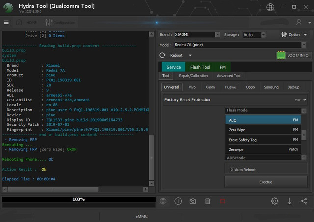

- Select FRP Lock Remove and click execute
                   Qualcomm Service Tool
                  Factory Reset Protection
                            Auto
Port  : Auto
Getting device info. [Connected].Ok
Device MODE : Firehose
Ping.. Ok
Configuration[FHProt_Auto]......
Ok
MemoryName : eMMC
TargetName : 8937
Version : 1
Memory Type         : eMMC
Page Size           : 512
Running : Ok
Reading GPT[3]
          Drive [0] 60 Items
          Drive [1] 0 Items
          Drive [2] 0 Items
build.prop
system
build.prop
  Brand          : Xiaomi
  Model          : Redmi 7A
  Product        : pine
  SDK            : 28
  Release        : 9
  ABI            : armeabi-v7a
  Locale         : en-GB
  Device         : pine
- Removing FRP
Executing ...
- Removing FRP [Zero Wipe] OkOk
Rebooting Phone.... Ok
Action Result :  Ok
Elapsed Time : 00:00:04
