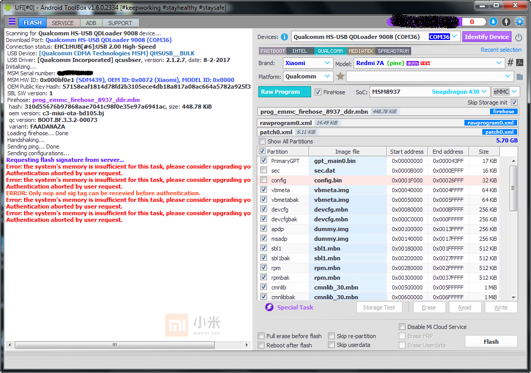

UFi Redmi 7A During Write Flash This Error Coming the system memory is insufficient for this task So Check Inside Threat Plese

hello everyone today in my shop Redmi 7a With Hang On LOGO Condition Than I am Trying write Flash Flash But This Error Coming During Write Flash So Please Help Me
Note: i was try other tools write flash successfully but still hang on LOGO Condition
so please help me UFI Box Team

Auth loder has been given in this of redmi 7a. you will need creadit to flash it and it will work only when xiaomi auth server is active.
you can flash it with any other tool Like unlock tool, umt, miracle, mrt etc.

Sir I was try with umt write flash successfully but still hang on logo
If I try with ufi Emmc module than can solve this problem but I do not know how to repair with ufi Emmc module

Might be problem with emmc. you check health report from ufi.
