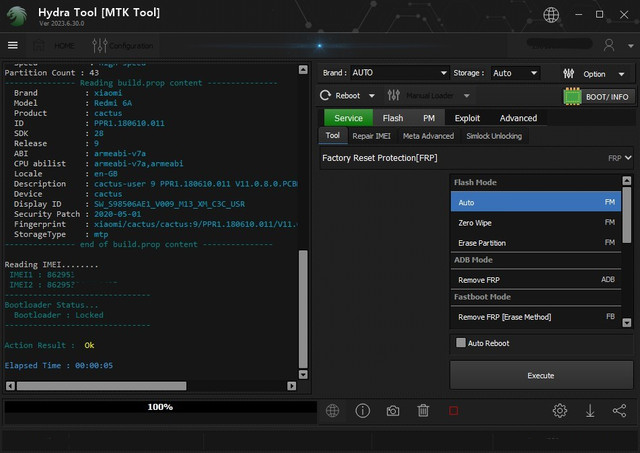

- Factory Reset Phone
                      Service Function
              Format/Factory Reset/ScreenLock
                            Auto
  MTK Port Type   : Flashmode BROM
  FriendlyName    : MediaTek USB Port_V1632 (COM30)
  Device          : /7&d3e40fc&0&4
  SymbolicName    : \\?\usb#vid_0e8d&pid_0003#7&d3e40fc&0&4#{a5dcbf10-6530-11d2-901f-00c04fb951ed}
  Driver Ver      : 01/22/2015,3.0.1504.0
  Service         : wdm_usb
Openning Port [COM30] Ok
Reading Partition Table ..
  ERAM Size       : 0x000000000003A000-232 KB
  IRAM Size       : 0x0000000080000000-2 GB
  EMMC RPMB Size  : 0x0000000000400000-4 MB
  EMMC USER Size  : 0x00000003AB400000-14.676 GB
  EMMC CID        : 90014A484147346132A50309E49265FF - HAG4a2
  HW-CODE         : 0x766
  HWSUB-CODE      : 0x8A00
  HW-VERSION      : 0xCA00
  SW-VERSION      : 0x0
  CHIP-EVOLUTION  : 0x0
  DA-VERSION      : 1.0
  Speed           : high-speed
Partition Count : 43
  Brand          : xiaomi
  Model          : Redmi 6A
  Product        : cactus
  SDK            : 28
  Release        : 9
  ABI            : armeabi-v7a
  CPU abilist    : armeabi-v7a,armeabi
  Locale         : en-GB
  Description    : cactus-user 9 PPR1.180610.011 V11.0.8.0.PCBMIXM release-keys
  Device         : cactus
  Display ID     : SW_S98506AE1_V009_M13_XM_C3C_USR
  Security Patch : 2020-05-01
  Fingerprint    : xiaomi/cactus/cactus:9/PPR1.180610.011/V11.0.8.0.PCBMIXM:user/release-keys
  StorageType    : mtp
Reading IMEI........
IMEI1 : 862953********
IMEI2 : 862953********
Bootloader Status...
  Bootloader : Locked
   Factory Reset Flash Mode..
Operation : Safeformat Universal...
Action Result :  Ok
Elapsed Time : 00:00:04
- FRP Lock Remove
                      Service Function
               Factory Reset Protection[FRP]
                            Auto
  Service         : wdm_usb
  HW-CODE         : 0x766
  HWSUB-CODE      : 0x8A00
  HW-VERSION      : 0xCA00
  SW-VERSION      : 0x0
  DA-VERSION      : 1.0
  Speed           : high-speed
  Brand          : xiaomi
  Model          : Redmi 6A
  Product        : cactus
  SDK            : 28
  Release        : 9
  ABI            : armeabi-v7a
  Locale         : en-GB
  Device         : cactus
  StorageType    : mtp
IMEI1 : 862953*********
IMEI2 : 862953*********
  Bootloader : Locked
Action Result :  Ok
Elapsed Time : 00:00:05
