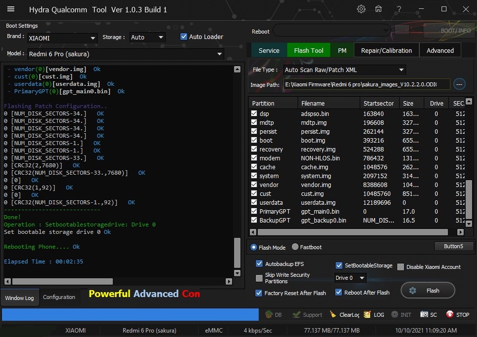

Hydra Redmi 6 (sakura) Edl Flashıng by Hydra
sero408
Sep 26, 2021
893
94
türkiye
Quote:
Searching for Qualcomm 9008 Device... Found
FriendlyName : Qualcomm HS-USB QDLoader 9008 (COM110)
SymbolicName :??USB#VID_05C6&PID_9008#6&27800d7b&0&4#{a5dcbf10-6530-11d2-901f-00c04fb951ed}
Driver Ver : 08/02/2017,2.1.2.7
Getting device info .. . ...
Serial No.: 0xD599C1D5
HW_ID : 000460E100000000
MSM ID : 0x000460E1, MSM8953-Qualcomm Snapdragon 625
MODEL_ID : 0x0000
OEM_ID : 0x0000 - QUALCOMM
PBL Ver : 00000002
PK HASH : 57158eaf1814d78fd2b3105ece4db18a817a08ac664a5782a9 25f3ff8403d39a
Firehose Loader [Xiaomi_Remi 6 pro_******_8953_ddr.mbn]
Header Type : OLD
TargetMSM : 8953
Tag : _auth_peek
Version : 3
Code_size : 288
Signature_size : 256
fhVendor : XIAOMI
Vendor : QUALCOMM
OEM_ID : 0000
MODEL_ID : 0000
SW_ID : 0000000200000003
APP_ID :
pk_hash : 57158eaf1814d78fd2b3105ece4db18a817a08ac664a5782a9 25f3ff8403d39a
OEM_VERSION : c3-bsp-builder-job002.bj
IMAGE_VARIANT : JAADANAZA
QC_VERSION : BOOT.BF.3.3-00228
SaharaBoot... Ok
Sending ....................b Okb0
Connecting to Firehose...
Ping ... Ok
Configuration.
Signature Request -> bob[BX0rp42lF0fZ7vuQQDljIsuP2cJ]
Signature @256bytes Authentication.... Accepted ......
Identifying Chip....
Ok
Chip Configuration :
MemoryName : eMMC
MaxXMLSizeInBytes : 4096
TargetName : 8953
Version : 1
*** STORAGE DEVICE INFO ***
Memory Type : eMMC
Block Size in Bytes : 512
Page Size : 512
Manufacturer ID : 144
Serial Number : 3281161589
Firmware Version : 162
Product Name : HCG8a4
Physical titions : 3
Total Logical Blocks:
Drive [0] 122142720 [58.242 GB]
Drive [1] 8192 [4 MB]
Drive [2] 8192 [4 MB]
Protocol : Universal
Running : Ok
Phone Information .....
Brand : xiaomi
Vendor : Xiaomi
Model : Redmi 6 Pro
SDK : 28
Release : 9
ABI : arm64-v8a
Locale : zh-CN
Description : ******-user 9 PKQ1.180917.001 V12.0.1.0.PDICNXM release-keys
Miui Ver : V12
Device : ******
Display ID : ZQL1715-******-build-20200728120204
Security Patch : 2020-07-01
Emmc_size : 16GB
Fingerprint : xiaomi/******/******:9/PKQ1.180917.001/V12.0.1.0.PDICNXM:user/release-keys
Reading GPT[3]
Drive [0] 60 Items
Drive [1] 0 Items
Drive [2] 0 Items
Backup Security titions...
Reading Security Items....
> modemst1
> modemst2
> fsg
> fsc
C:UsersThiha MobileDesktopHydraTool_Fullpackage_05-16-2021_ps_hydratoolBackupSecurity_BackupRedmi 6 Pro__9_Security_101021110652.sec
Backup Security Success....
Flashing Selected titions....
- sec (0)b [sec.dat] b0 Ok
- config (0)b [config.bin] b0 Ok
- lksecapp (0)b [lksecapp.mbn] b0 Ok
- lksecappbak (0)b [lksecapp.mbn] b0 Ok
- devcfg (0)b [devcfg.mbn] b0 Ok
- devcfgbak (0)b [devcfg.mbn] b0 Ok
- apdp (0)b [dummy.img] b0 Ok
- msadp (0)b [dummy.img] b0 Ok
- sbl1 (0)b [sbl1.mbn] b0 Ok
- sbl1bak (0)b [sbl1.mbn] b0 Ok
- rpm (0)b [rpm.mbn] b0 Ok
- rpmbak (0)b [rpm.mbn] b0 Ok
- cmnlib (0)b [cmnlib_30.mbn] b0 Ok
- cmnlibbak (0)b [cmnlib_30.mbn] b0 Ok
- cmnlib64 (0)b [cmnlib64_30.mbn] b0 Ok
- cmnlib64bak (0)b [cmnlib64_30.mbn] b0 Ok
- keymaster (0)b [keymaster64.mbn] b0 Ok
- keymasterbak (0)b [keymaster64.mbn] b0 Ok
- misc (0)b [misc.img] b0 Ok
- aboot (0)b [emmc_appsboot.mbn] b0 Ok
- abootbak (0)b [emmc_appsboot.mbn] b0 Ok
- tz (0)b [tz.mbn] b0 Ok
- tzbak (0)b [tz.mbn] b0 Ok
- splash (0)b [splash.img] b0 Ok
- dsp (0)b [adspso.bin] b0 Ok
- mdtp (0)b [mdtp.img] b0 Ok
- persist (0)b [persist.img] b0 Ok
- boot (0)b [boot.img] b0 Ok
- recovery (0)b [recovery.img] b0 Ok
- modem (0)b [NON-HLOS.bin] b0 Ok
- cache (0)b [cache.img] b0 Ok
- system (0)b [system.img] b0 Ok
- vendor (0)b [vendor.img] b0 Ok
- cust (0)b [cust.img] b0 Ok
- userdata (0)b [userdata.img] b0 Ok
- PrimaryGPT (0)b [gpt_main0.bin] b0 Ok
0 [NUM_DISK_SECTORS-34.] OK
0 [NUM_DISK_SECTORS-1.] OK
0 [NUM_DISK_SECTORS-33.] OK
0 [CRC32(2,7680)] OK
0 [CRC32(NUM_DISK_SECTORS-33.,7680)] OK
0 [0] OK
0 [CRC32(1,92)] OK
0 [0] OK
Done!
Rebooting Phone.... Ok
Elapsed Time : 00:02:35
