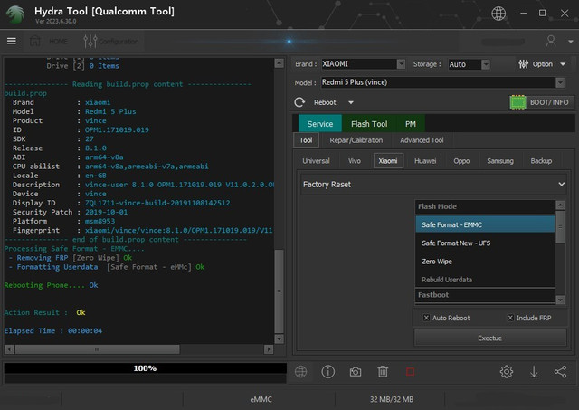

- Select Factory Reset
                        Xiaomi Tool
                       Factory Reset
                     Safe Format - EMMC

Processing Safe Format - EMMC....
- Removing FRP [Zero Wipe] Ok
- Formatting Userdata  [Safe Format - eMMc] Ok
Rebooting Phone.... Ok
Action Result :  Ok
Elapsed Time : 00:00:04
