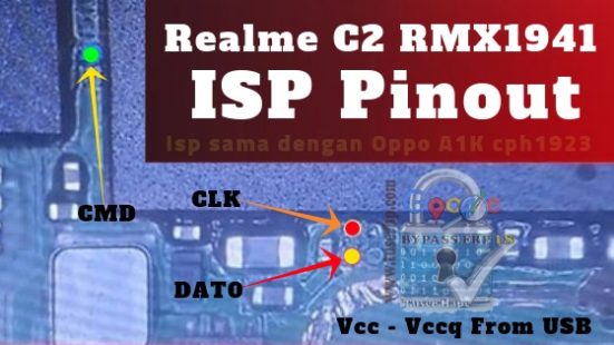

Just follow the picture to isp pin out
Actually i have to credit this picture to original posted i dont who he is
see the picture and follow

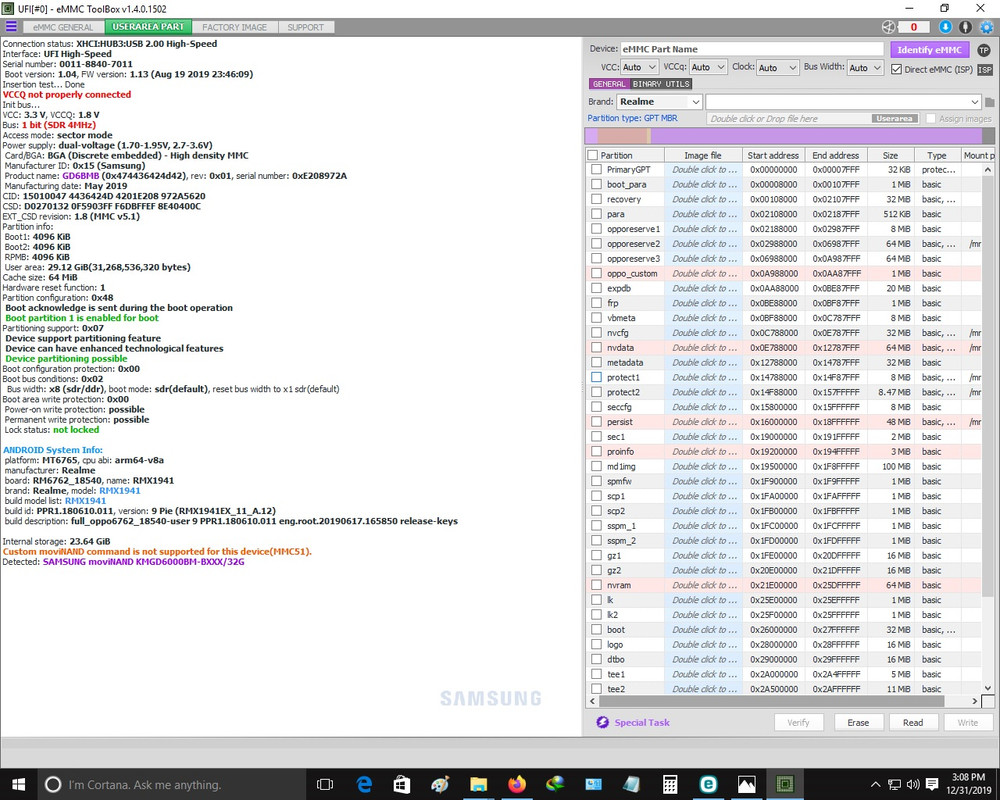

i ried fisrt master clear code but failed
so i try factory reset to special task
i ried to many time to factory reset it always show an error

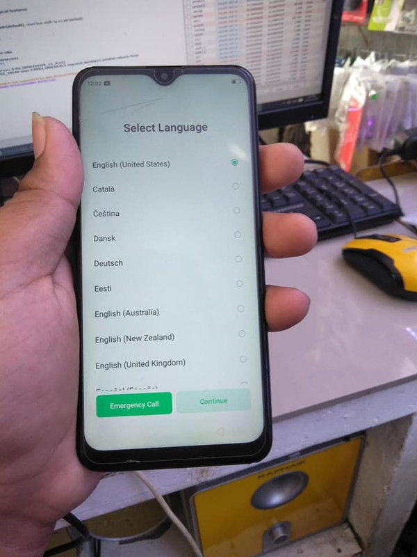

i tried to sucess
an error showing only an
Writing userdata... Unknown chunk type 0x0000 at 0x00E0A0C4
logs
VCCQ not properly connected
Init bus...
VCC: 3.3 V, VCCQ: 1.8 V
Bus: 1 bit (SDR 4MHz)
Access mode: sector mode
Product name: GD6BMB (0x474436424d42), rev: 0x01, serial number: 0xE208972A
Manufacturing date: May 2019
CID: 15010047 4436424D 4201E208 972A5620
CSD: D0270132 0F5903FF F6DBFFEF 8E40400C
EXT_CSD revision: 1.8 (MMC v5.1)
Partition info:
Boot1: 4096 KiB
Boot2: 4096 KiB
RPMB: 4096 KiB
User area: 29.12 GiB(31,268,536,320 bytes)
Factory Reset...
Creating filesystem with parameters:
Block size: 4096
Blocks per group: 32768
Inodes per group: 7008
Inode size: 256
Journal blocks: 1312
Label:
Blocks: 83968
Block groups: 3
Reserved block group size: 23
Created filesystem with 13/21024 inodes and 2687/83968 blocks
Writing cache... Wrote 30290707 blocks, expected to write 83968 blocks
Done
Block size: 4096
Inodes per group: 8160
Inode size: 256
Journal blocks: 32768
Label:
Blocks: 6197499
Block groups: 190
Reserved block group size: 1024
Created filesystem with 11/1550400 inodes and 141348/6197499 blocks
Wrote 50411262 blocks, expected to write 6197499 blocks
Done
Done
