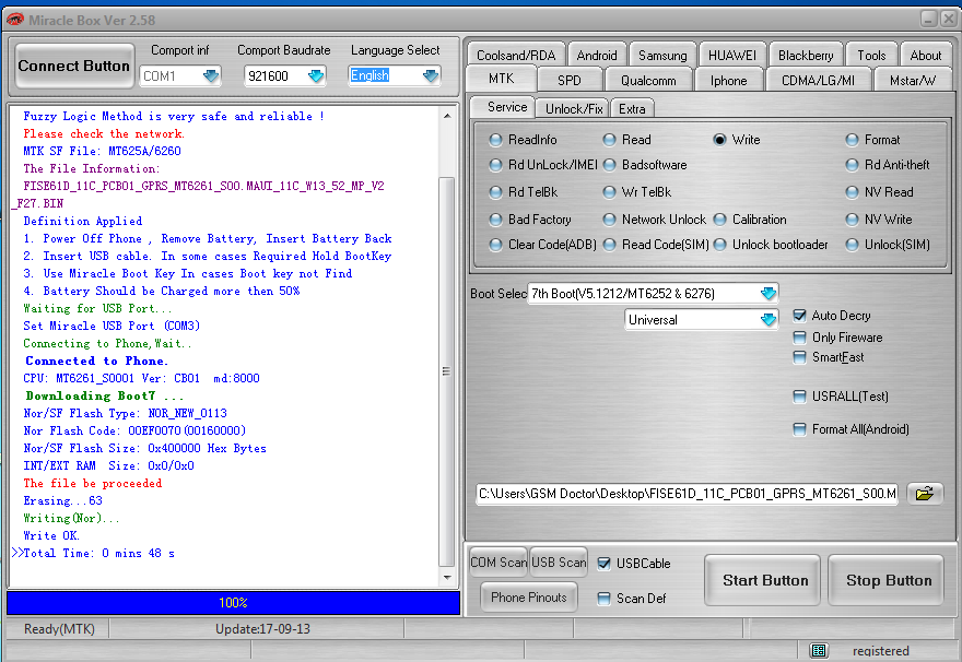

I need Q Mobile E4 flash file. I flashed it with wrong file MT6250 and it was dead. Then I flashed with MT6261 but ver not same therefore now phone is on on white screen and also gives sound. Before flashing it was ok.
CPU Detail is as under
MT6261_S0001 Ver: CB01 md:8000
Please someone share his backup or give correct cpu file link.

I took same Model of QMobile with same cpu from one of my friends and read its flash in miracle. Then I flashed my phone with that file. Now my phone is 100% ok. Here is the log
