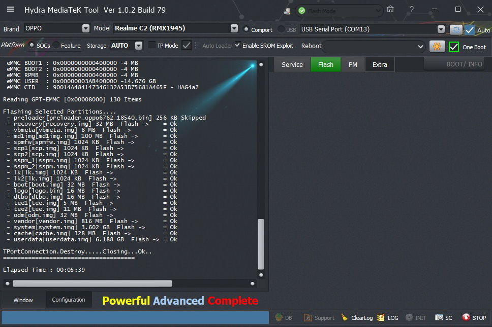

Oppo Realme C2 (RMX1945) Flashing successfully done by Hydra Tool
Brand : OPPO Model : Realme C2 (RMX1945) Connection : Flash Mode
How To Boot : Power off phone
* BROM Mode : Press VOL + or Press VOL -+
Connection
-Please wait...
-Connect Phone...
-Found...[COM54]
TPortConnection.Create...(COM54)..Opening...Ok
Handshaking...Ok
Identifying Hardware ID.....
BROM CPUID : 0766MT6765[6765]
getMTKPayloadExploit : 0766
#Executing Exploit..
#SUCCESS..
Handshaking...Ok
FUSEID : 00000000
SECURE VERSION : 05
BL VERSION : FE
BR Secured : E0
Preparing Download Agent..
DA : [Not Exist]
Trying Default 6765.bin
Ver : MTK_AllInOne_DA_v3.3001.2020-11-03.22:07_536568
Init : Loader [1]
Sending : Accepted
Identifying Protocol...
Protocol : New
Synchronization...SYNC
Mode : brom
Preloader Initialization...
Parsing preloader_oppo6762_18540.bin
Init : Accepted
Execute Secondary Loader
Init : Loader [2]
Executing : SYNC
UNIQUE ID : C4A76F31FDECEE2950FB06FB19B3AA46
ERAM Size : 0x000000000003A000 -232 KB
IRAM Size : 0x0000000080000000 -2 GB
eMMC USER : 0x00000003AB400000 -14.676 GB
eMMC CID : 90014A484147346132A53D75681A465F - HAG4a2
DA Speed : high-speed
Reading System Info
Autobackup Partitions
-> Renaming Preloader.... preloader_oppo6762_18540.bin
Creating Scatter file... C:\Hydra Tool\\Backup\Auto\__0766--__100221190931\MT6765_Android_scatter.txt
-frp[0x0BE88000]1024 KB ->frp.bin...Ok
-nvdata[0x0E788000]64 MB ->nvdata.bin...Ok
-persist[0x16000000]48 MB ->persist.bin...Ok
-nvram[0x21E00000]64 MB ->nvram.bin...Ok
Done!!!
- preloader[preloader_oppo6762_18540.bin] 256 KB Skipped
- recovery[recovery.img] 32 MB Flash -> = Ok
- vbmeta[vbmeta.img] 8 MB Flash -> = Ok
- md1img[md1img.img] 100 MB Flash -> = Ok
- spmfw[spmfw.img] 1024 KB Flash -> = Ok
- scp1[scp.img] 1024 KB Flash -> = Ok
- scp2[scp.img] 1024 KB Flash -> = Ok
- sspm_1[sspm.img] 1024 KB Flash -> = Ok
- sspm_2[sspm.img] 1024 KB Flash -> = Ok
- lk[lk.img] 1024 KB Flash -> = Ok
- lk2[lk.img] 1024 KB Flash -> = Ok
- boot[boot.img] 32 MB Flash -> = Ok
- logo[logo.bin] 16 MB Flash -> = Ok
- dtbo[dtbo.img] 16 MB Flash -> = Ok
- tee1[tee.img] 5 MB Flash -> = Ok
- tee2[tee.img] 11 MB Flash -> = Ok
- odm[odm.img] 32 MB Flash -> = Ok
- vendor[vendor.img] 816 MB Flash -> = Ok
- system[system.img] 3.602 GB Flash -> = Ok
- cache[cache.img] 328 MB Flash -> = Ok
- userdata[userdata.img] 6.188 GB Flash -> = Ok
Elapsed Time : 00:05:39
